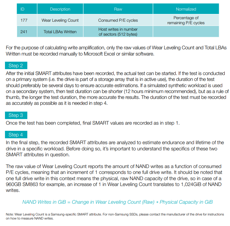

Both SSD Wear_Leveling_Count indicate 44 and 45, init value was 0, BTW I m not confirm 44 actual % meaning, but if according Total_LBAs_Written, it still under endurance spec.
Got some info. as below, so 45 means writing 45TiB

Well, I'm going to need some help translating the Wear_Leveling_Count.  You're saying I've written 45TB to the drive?!?!?  I don't understand how that could happen.
Also, I'm not excited to read that report of other 870 EXOs failing...
Around that yes, you can easily calculate based on this attribute:
241 Total_LBAs_Written      -O--CK   099   099   000    -    101015376296
101015376296 x 512 (sector size) = 51 719 872 663 552 bytes, or 47.04 TiB

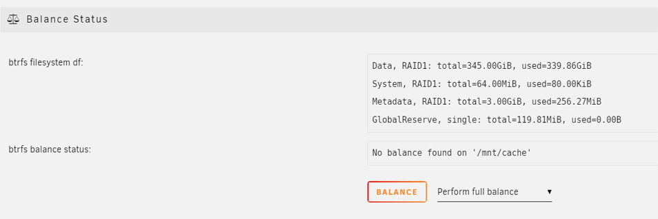

I sent one of the cache pool drives back to Samsung.  They sent a new(?) refurbished replacement.  I added the replacement drive to the pool and Unraid did a parity check and found no errors.  Is that all I need to do prior to RMA'ing the other, original, cache drive.  I've never done this procedure before and want to make sure I'm good to remove the other faulty drive.  Is "no balance found" relevant?
Parity check is for the array, you can run a scrub on the pool.
