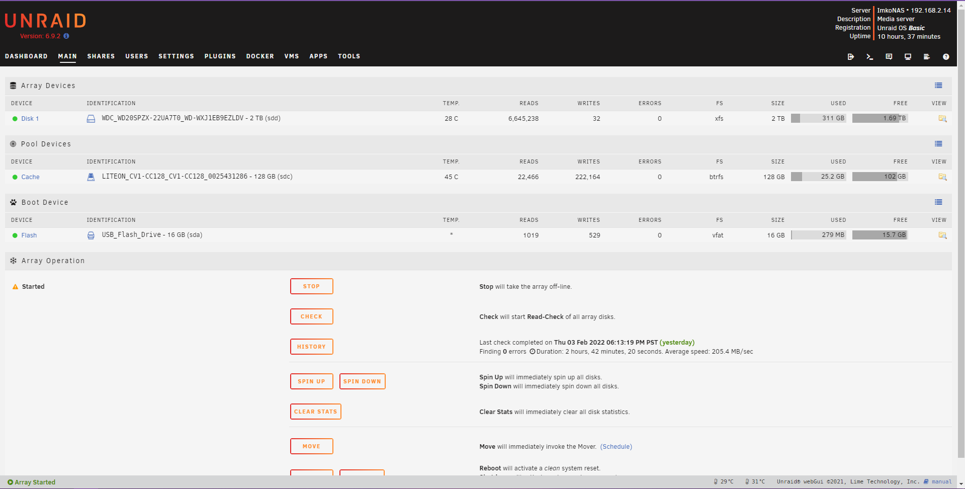

I have ran in to a bit of a problem to say the least. I have a unraid server with just a boot ssd and a 2tb hdd for storage, its not protected or anything. I rarely use it and i put some backup stuff on there.
After a month i scanned it and went to bed and woke up to 480 milion errors. Windows is not showing any files and krusader isn't showing any files in my storage folder. But unraid tells me in using 301GB of space on the drive? does this mean not everything is gone or am i too late

Your diagnostics showed no parity assigned and no disk assigned to disk1. Your first post implied you didn't have parity, so there is no way you can rebuild anything, which is what those steps you posted are designed to do.
Post new diagnostics and a screenshot of Main - Array Devices

The scan is complete and it has 0 errors now. and all the files are back.
What i did was shutdown the system, Reconnect the cables, Turn system back on. Then i ran a check it still had 488 milion errors.
Then in main i stopped the array. The devices list popped up i deselected WDC 2TB and scrolled down it said i cant start it cuz missing drive (makes sense) then on disk 1 i just reselected WDC 2TB. Started the array and checked 0 errors and the files now work
So i dont know how it fixed it but it did. diagnostics are in attachments
