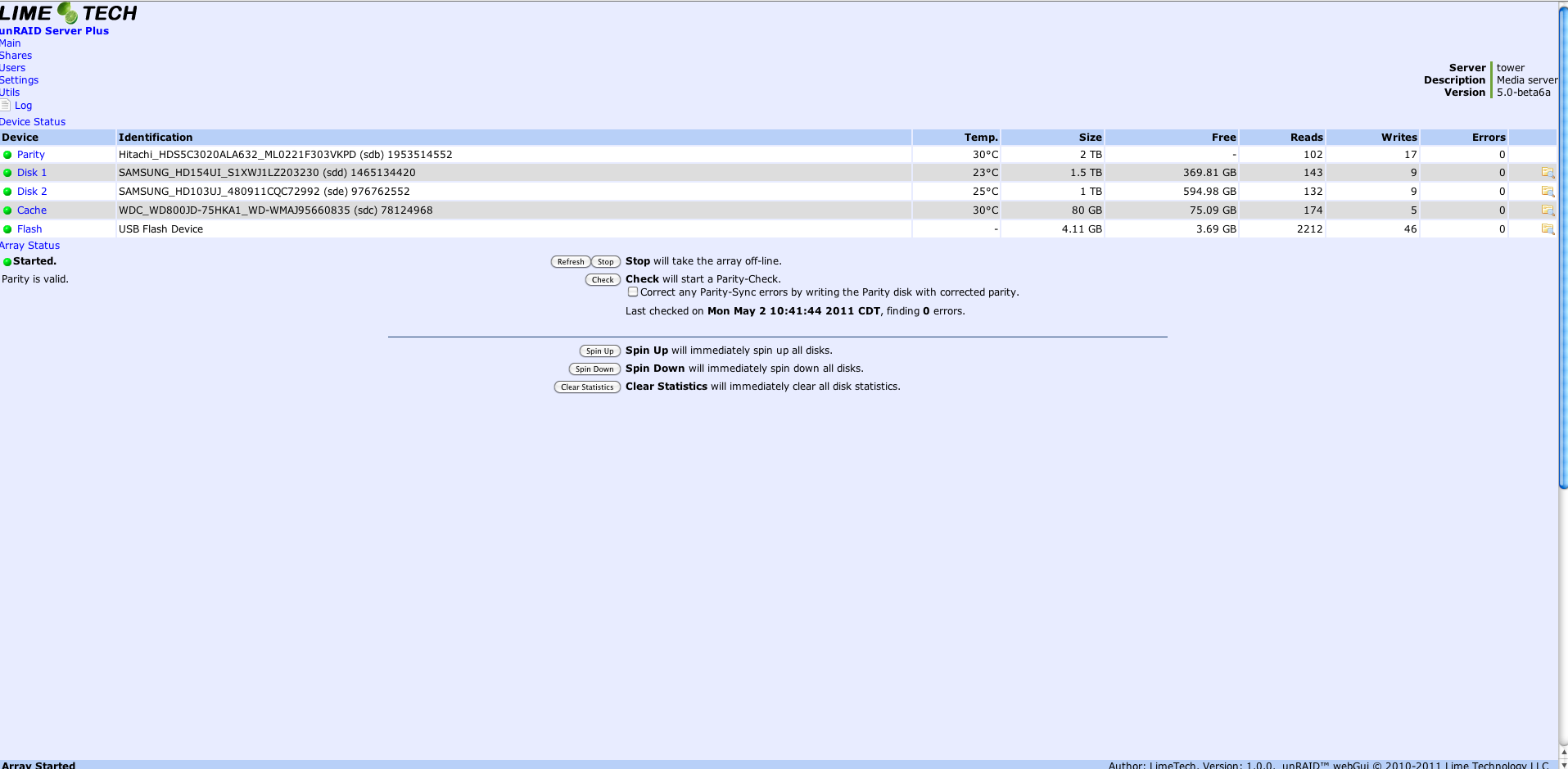

What did I do wrong...
Here's what mine looks like...
Here's my go script
#!/bin/bash
# Start the Management Utility
/usr/local/sbin/emhttp &
/boot/unmenu/uu
cd /boot/packages && find . -name '*.auto_install' -type f -print | sort | xargs -n1 sh -c
/boot/unmenu/uu
/boot/unmenu/uu
/boot/unmenu/uu
/boot/unmenu/uu
sleep 5
/boot/webGui/install.sh
Post the contents of your install.sh file.
And why do you have /boot/unmenu/uu 4 times in a row, after you already loaded it?
I also modified speeding_ant's install.sh, if you want to try mine:
http://pastebin.com/7eBHysqb
Just fill in the top 2 variables if they're different.
