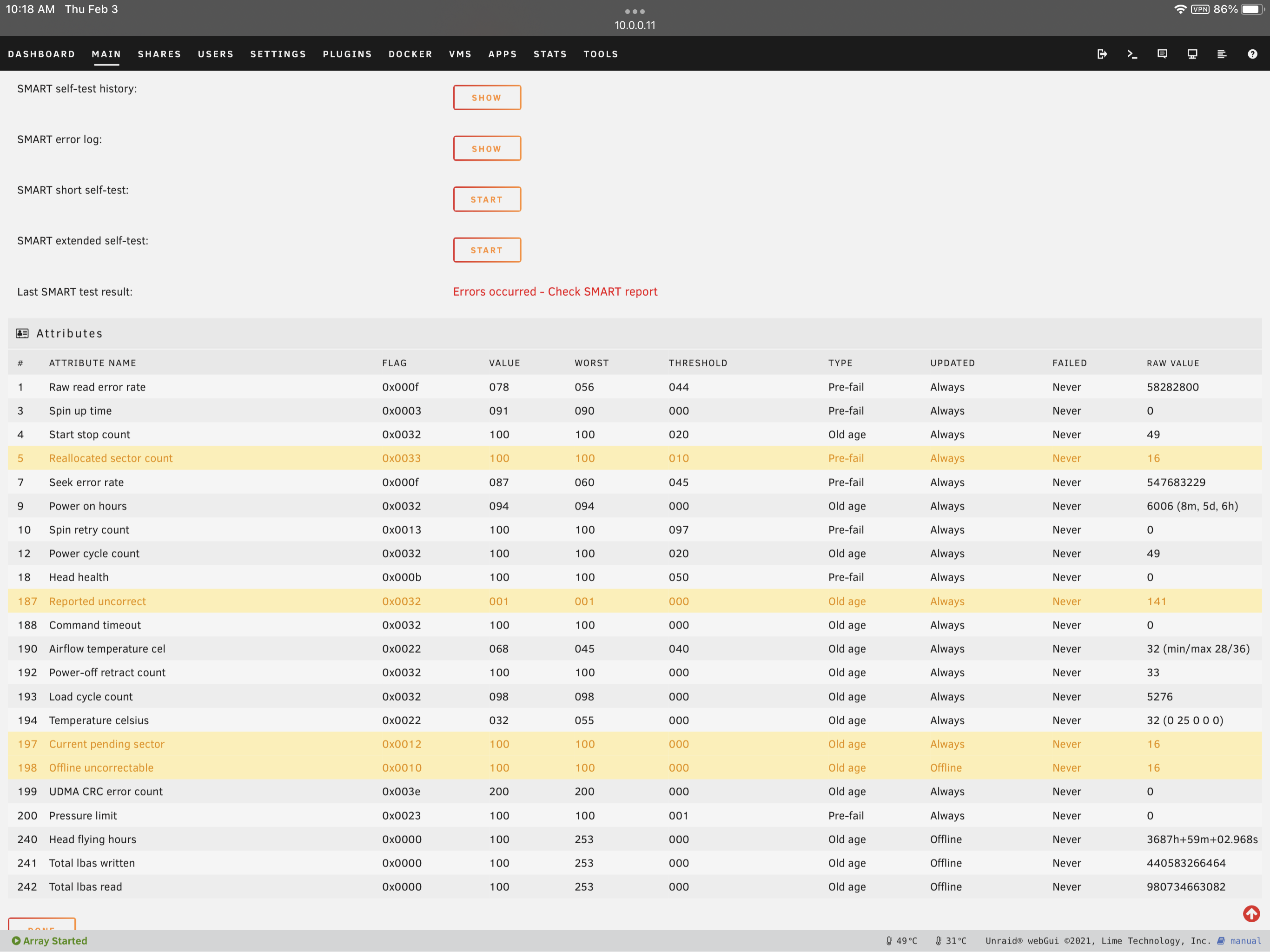

I have 15 hard drives in my server case (hot swap but I know unraid can’t use that).  I just got a bunch of errors after my parity auto-check ran so I ran a smart test on the parity1 disk (I am running two parity drives) and results are posted below in a screenshot.
I guess the drive is bad and I should replace hopefully they will replace under warranty.  However I’m not sure which drive this is as I didn’t label them at time of installation.  I was used to my synology system where it would flash the LED on a drive if you selected it so you could easily find which drive to pull if needed.

Added main screenshot showing error count

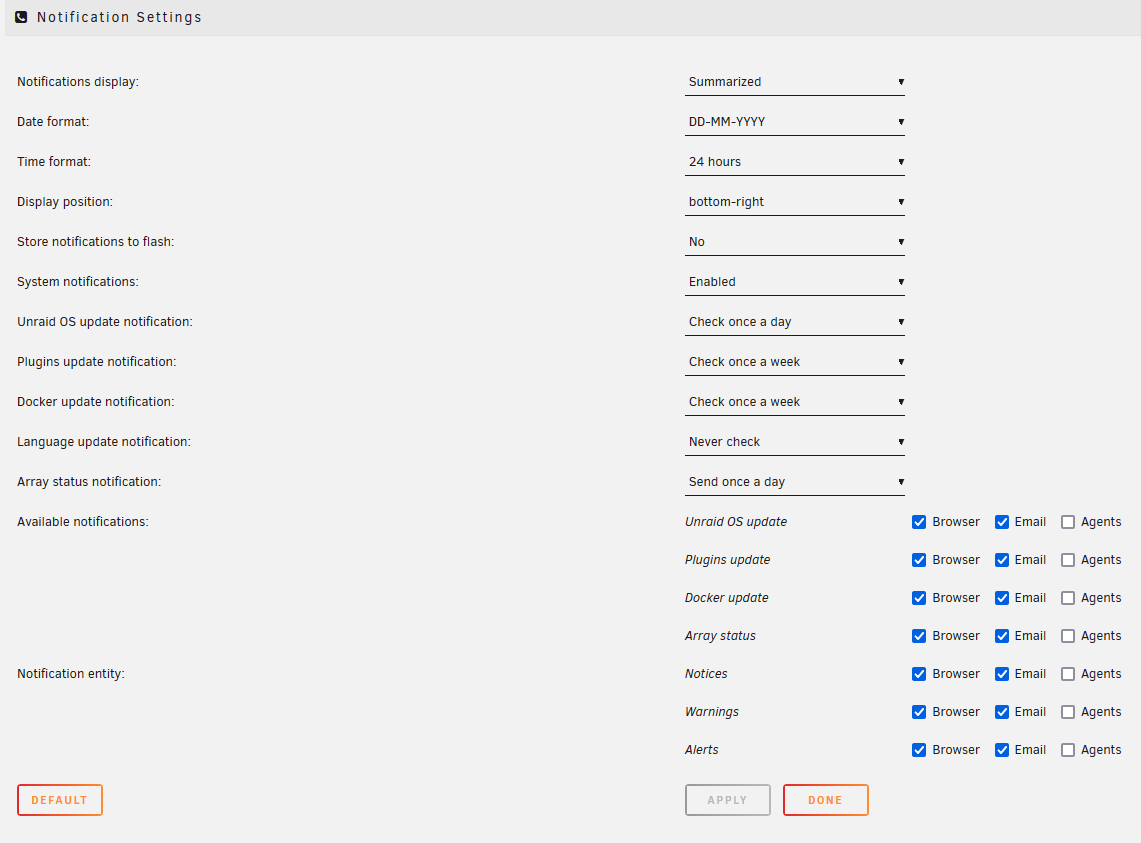

Setup Notifications to alert you immediately by email or other agent as soon as a problem is detected.
@trurl - I hadn't setup my smtp settings but I just did.  Don't see anything in notifications however to specify when it will notify me for smart errors.
Does putting a check for email on warnings and alerts do this?

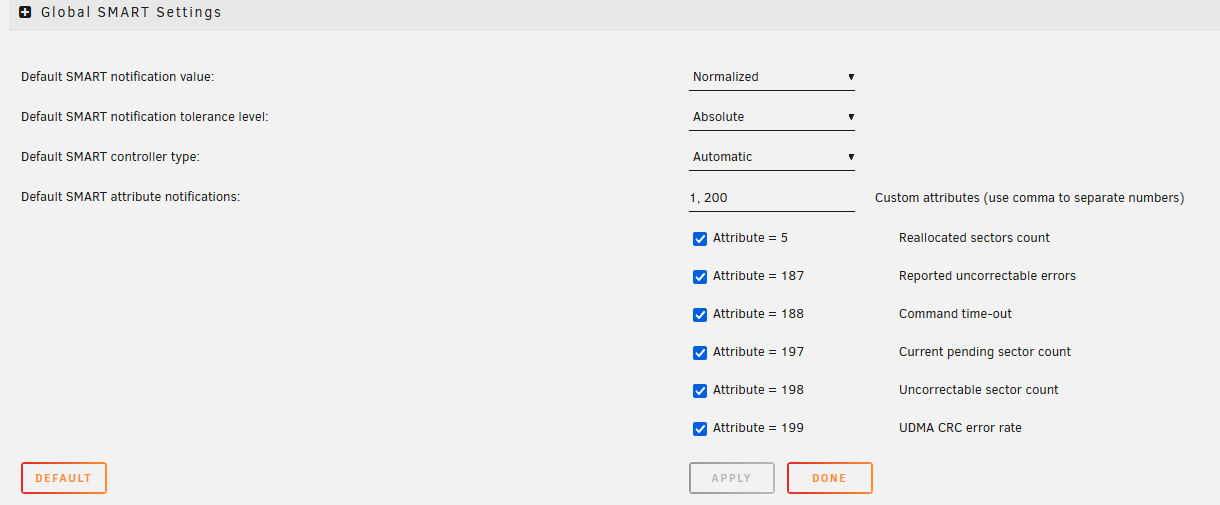

You can see which SMART attributes Unraid monitors in Settings - Disk Settings. You can also set those for individual disks by clicking on the disk to get to its settings. It is recommended to add attributes 1 and 200 for monitoring on WD disks.
Check that you have Notification set up like this:
and this on Settings >>  DiskSettings:
EDIT:  this will give a once-a-day email even when you have no problems.  I prefer this as it lets you know that the notification setup is working correctly!

Western Digital has two additional SMART parameters (Unique to WD) that indicate serious problems with Western Digital disks.  Adding these parameters ( SMART Attribute Number 1 and SMART Attribute Number 200) as shown in my screen capture checks for them.  IF you don't have WD disks, you don't have to add them.
