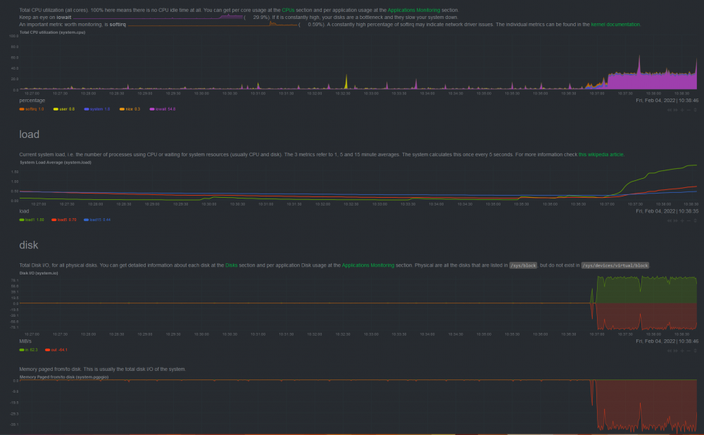

When I copy a large file via SMB (Edit: I mean, I copy a file from my PC to the Unraid server), I notice the transferspeed drops from the full 112 MB/s back to 40-ish after a couple of GB. I have seen some other topics about this issue, but I don't think they were conclusive in their solution. Some suggest the disks are faulty, but before I installed Unraid, they worked flawlessly (tested with both VMware and Windows Server). Adding SSD cache might work, but I figure a normal HDD should easily do 100 MB/s without SSD cache in between.

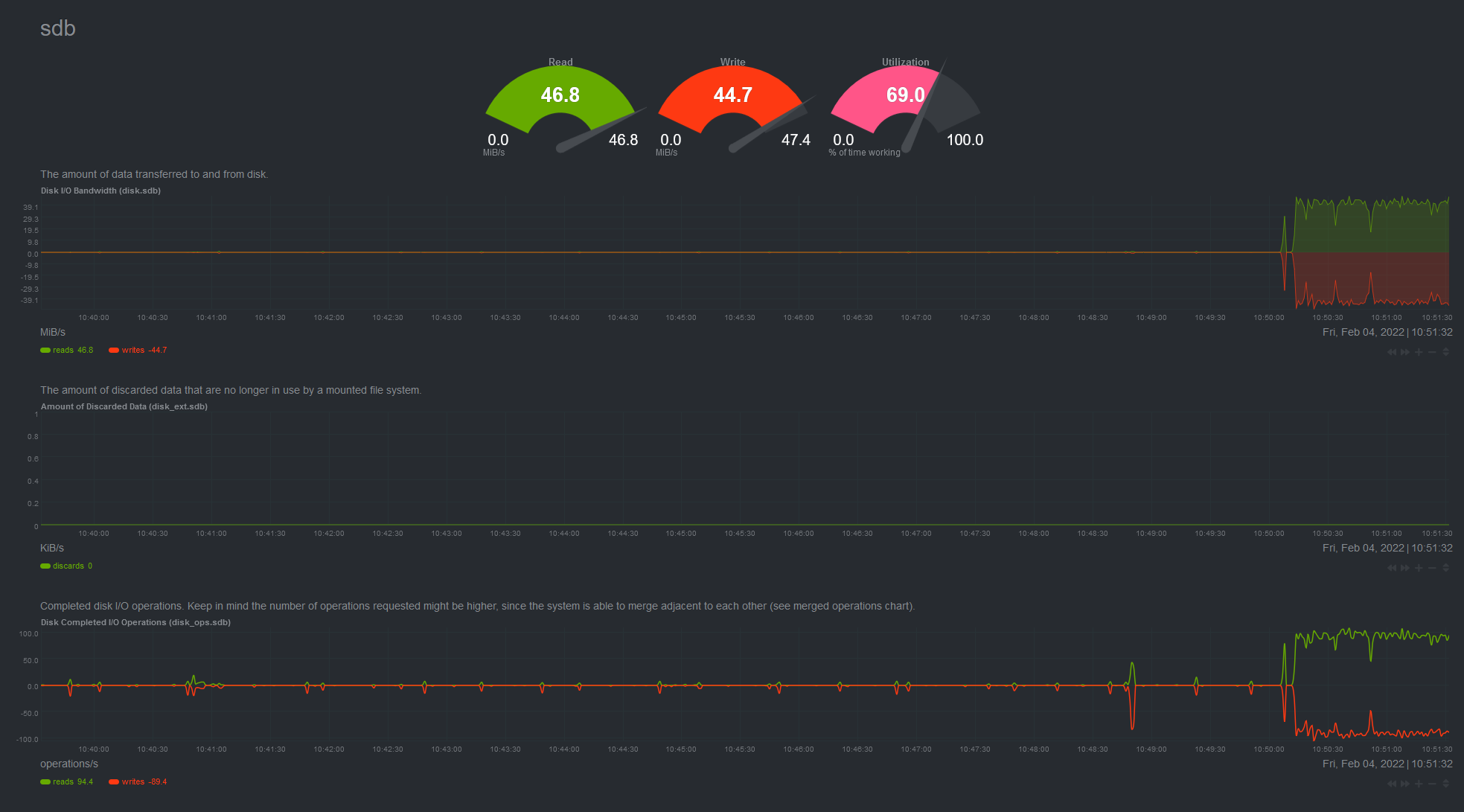

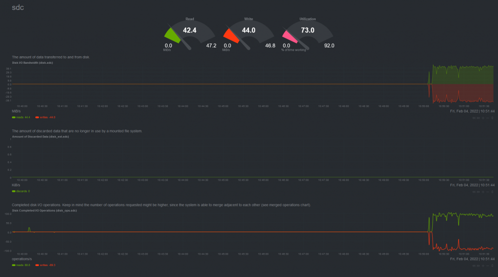

I installed netdata to try and get some insight into what's happening. I attached screenshots of this. The first screenshot shows the system both read and writes at around 80MB/s at the same time. On the second and third screenshot, you see both read and writes 40MB/s to both sdb and sdc. sdb is the 5TB parity disk, sdc is one of the 3TB data disks.
So if I interpret this correctly, it seems to:
- Write the file to the parity and data disk at the same time (good, redundancy!)
- Do this by reading the file after it has been written, instead of doing this in memory
Is this an Unraid issue or an xfs issue? I think it should calculate the parity while the file is in memory. Re-reading a file that has just been written seems very inefficient, and is obviously very taxing.

The initial burst you're seeing at line speed is when the writes are being cached in RAM.  Once that fills, then the writes have to happen directly to the drive.
Unraid has 2 writes modes:
  1. Read/Write/Modify - This is the default, allows drives not being involved in the writes to spin down so that only the parity drive and the disk in question are written to.  It is also the slowest since it has to read the contents of parity and the data disk, recalculate what the contents will be, wait for the drive to spin back around to the applicable sectors and then write the information.  IE: It's 2-3x slower than simply writing the info to the drive
  2. Reconstruct write: This basically writes the info directly to the data drive and the parity drive simultaneously but has to read from every other drive at the same time in order to get the proper parity information.  It will be the fastest (close to the write speed (or read speed of the slowest drive) but the caveat is that every drive has to be spun up for any write to the array.
Cache drives solve the problem because the writes can be cached to it and they're not involved in the parity system so will basically proceed at full line speed and then get moved to the parity protected array usually during off hours.
The 40MB/s is at the low end of average, but not an unacceptable number.
