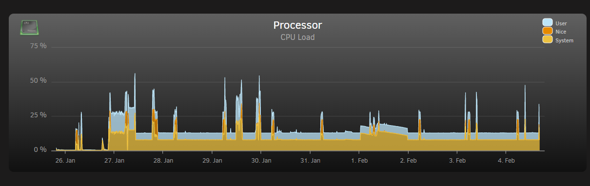

So the last few weeks I've noticed a higher than normal CPU load ( so I think anyway), CPU seems to be running hotter, system is idling at a higher power usage as well according to the UPS plugin.
I've tried turning off all my dockers without a change in load.
Changes I've mad recently since I've noticed, I set up the my server plugin, and I switched out 2 case fans that were running off the power supply to new fans running off system fan headers on the motherboard.

attached is my diagnostic. Is there a way to see a historical graph of system resource usage?
Found it, At least it goes back to last boot I believe, You can clearly see the change. image.thumb.png.69fb8d198199c29d16c0470f0ce233a2.png
Let me know what you guys think, Thanks!

The NTFS errors from from a UD device, if it's no longer connected reboot to clear them, the CPU utilization is because of this:
That seems to have worked. Thank you sir.
