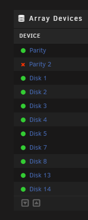

The parity drives are listed as "Parity - Invalid" and "Parity 2 - Disabled"

OK, the parity run finished. However 1/2 parity drives is listed as disabled. Again, I'm not sure if the original parity rebuild/array shrink completed since the GUI crashed while the rebuild was happening.orcrist-diagnostics-20220206-1137.zip
Doesn't matter since this time it completed and rebuilt all of parity. Unfortunately, parity2 had already been marked disabled so it wasn't rebuilt.
Doesn't seem to be anything wrong with parity2 disk, can't see what disabled it since you had to reboot. Maybe a connection problem. You must always double check connections when mucking about inside.
Since it is only parity2 and doesn't contain any of your data no reason to not rebuild it to the same disk. You could have rebuilt it at the same time as parity with another New Config but since you didn't you will have to rebuild it now.
Stop array, unassign parity2, start array without parity2 assigned, stop array, reassign parity2, start array to begin parity2 rebuild.
