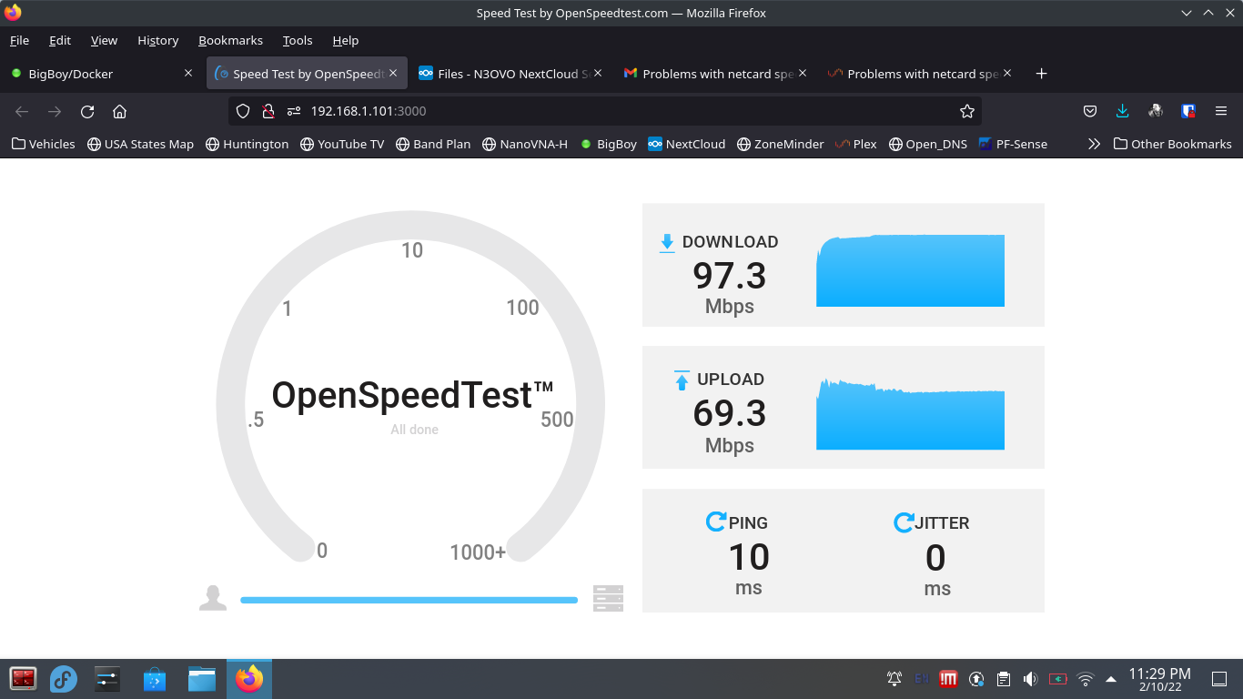

Problems with netcard speed. 1G card getting 81-91 upload and down loads
Hello, John G. here with a network problem

A happy longtime Pro user. I never had any major problems. That I could not get working. Well I have now, need help! Server has been running with no problems. We were using windows vm and found very slow downloads. jumped to a linux vm and found the same. only getting 11MB/s Download . If I check with a wired computer and i am getting around 950 MB/s Download.
so i installed  more network cards all showing 1000
what unraid show:
Mode of operation
eth0       1000 Mbps, full duplex, mtu 1500
eth1        1000 Mbps, full duplex, mtu 1500
eth2       interface down ( Ran out on network plugs)
eth3       1000 Mbps, full duplex, mtu 1500
eth4       interface down ( Ran out on network plugs)
eth5       interface down ( Ran out on network plugs)
any thoughts on why this going wrong... any help

did a screen shout in safe mode,  no change
Not really sure.  I'm going to assume that your switch that you're using actually supports bonding etc.  My only suggestion would be to simplify the network as a test and use a single cable instead.
