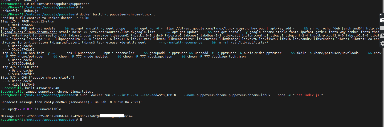

Hello, I managed to build the docker container for puppeteer and the script works as long as i do not reboot my server. Once i reboot it, i have to rebuild the docker again.
may i know if there is any method of keeping the docker build?
I found a solution to my problem.
create a docker image , upload the image the dockerhub and pull  the image to unraid and keep restart setting to on.
