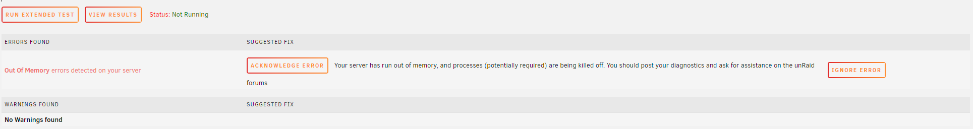

i could need some help as i been propted that the server is out of memory an i don't know what happend. As far as i was able to check ram was never over 40% usage.
Can anyone take a look and help me out what might be the problem and how to fix it?

What were you trying to edit with nano???  It was consuming 15Gig of memory
Hello Squid,
thank you for your answer, i really appreciate your help. As far as i am aware i didn't try to edit anything. The only files i opened with nano were configs for swag as i setup nextcloud so i am really confused how so much memory was in use.
Is there an way or log that i can check to find the files in use. I am kinda worried that i broke something while trying to get nextcloud to work.
At the time of the OOM, nano was open and was consuming ~15Gig.  Quite possible you opened the wrong file and then did the correct one, but it was the cause of the OOM
i think you are right.
Thank you for your help.
