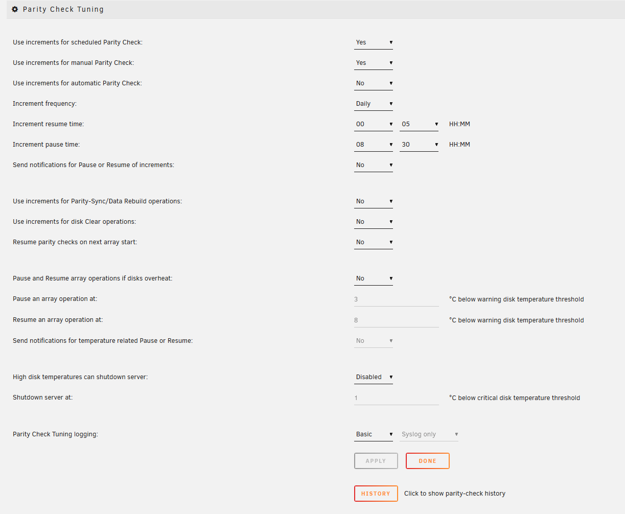

I use it on the Media Server which is 6TB 'tall'.  (Spec's for my two servers are in my signature.   IF you don't see signatures, click on your user-name in the header and go to account settings.
Here are the Parity Check Tuning settings that I use:
It takes two nights to complete the monthly parity check on this server.  The Testbed Server is only 3TB 'tall' so it runs in about eight hours which is not a problem for me.

I have my mover task setup to run daily at 3:00AM.  BUT it does not always have something to move.  I don't know if I have ever had both the parity check and mover running at the same time.  But I would suspect that it would impact the completion time of both.  Most of the time I would think that my mover task take from ten minutes to an hour-and-half.  I would suspect that if both were running it would double the time of both during the period of the mover operation.  But unless your delayed mover tasks take you into the active daytime usage period, what is the problem?  Both are background operations which should have no impact if it takes them a bit longer than normal.  Especially, the parity check.  Since one can set the Parity Check Tuning to run outside of normal usage hours, it makes no difference if the check is a hour or two longer in total duration.   (If the parity check is not paused during the usage hours, then a longer total elapsed time is a BIG Deal!)  So my advice would be run the parity check during the total available out-of-usage hours and let it end when it will.  One problem is that as the array becomes 'taller', the parity check time will be be over twenty four hours and , at three hours per night, it will take eight days plus to complete the check.  (This is a problem which many folks have not considered when looking at drives with very large capacities!  Think 16TB's...)
