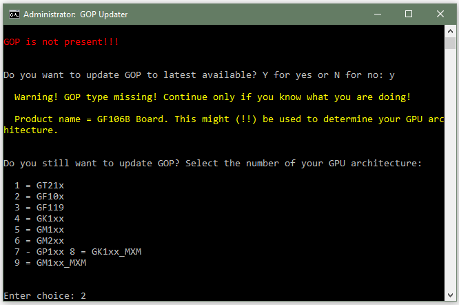

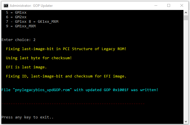

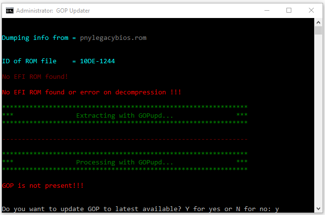

You could also dump your own vbios (preferred) and add support for uefi gop, with a windows tool called GOP Updater.
Your gpu is gk104 (gpu architecture=4):
Your modified vbios will be in the same folder of the tool
