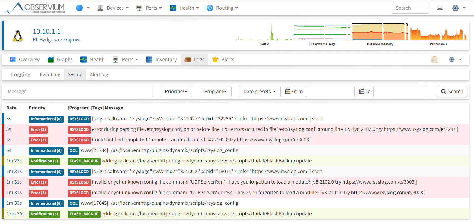

I added logs in my post right after the crash. I also turned on the sending of logs to the observium and I'm waiting. So far, I haven't found anything in the logs.

It is with logs that I am waiting for something to appear in the Observium.

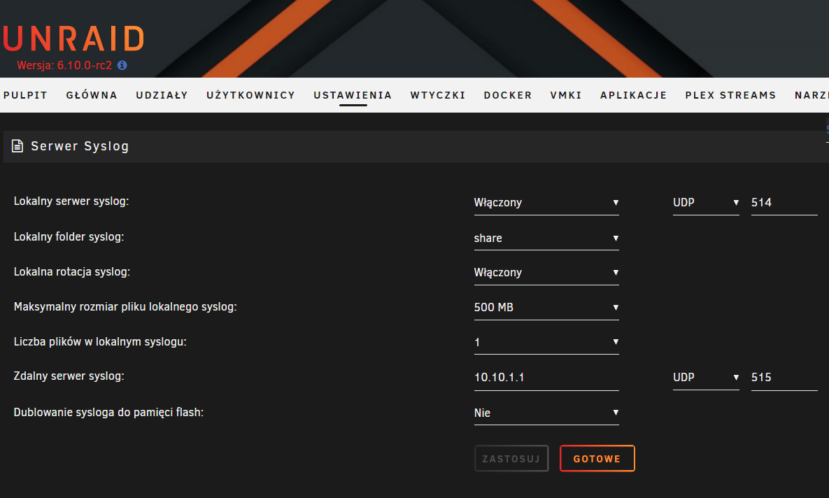

I set docker back to bridge from host even though the host mode takes less ram.
I discovered a conflict when the Observium was as the host that port 514 was using. I changed to bridge and set it to 515 because Observium is on the same IP as unRaid.
Another problem seems that rsyslog was unable to save logs after overflow (i think) on local share or sent to syslog. Then was frezze.
