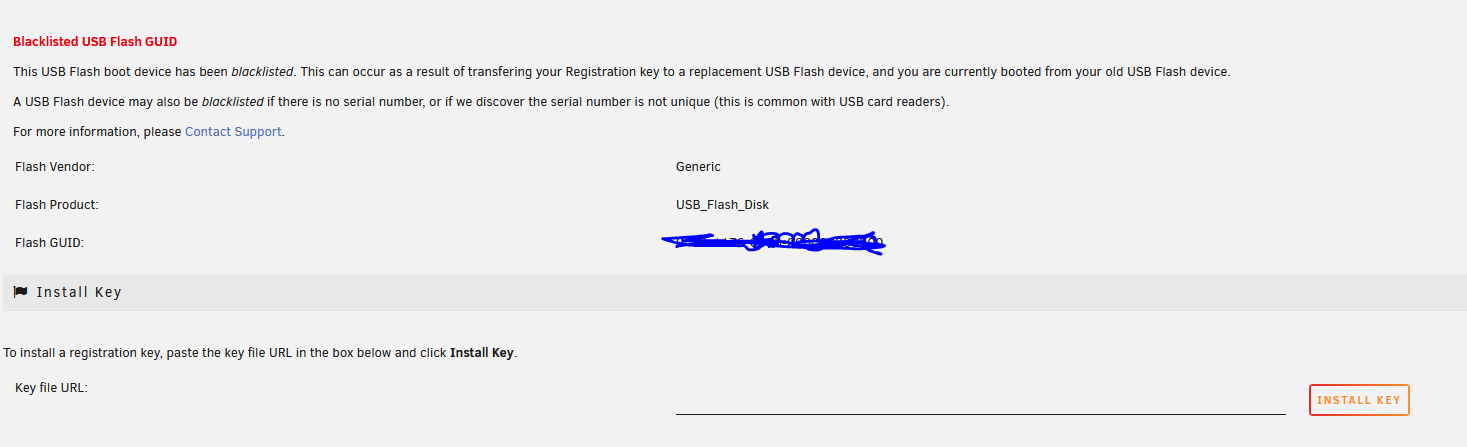

February 7, 20224 yr Hi! Im new in the UNRaid World I now i have a Problem So let me explain. I bought a few Days ago a new system an i wanted to test UNRaid I installed the OS an i had many Problems with it. The System shuteddown after few hours or over few minutes. So i decided to check my USB Flash and i found out that it was a little bit to broken. I bought a new USB FLash an it never happend again. After that i freshinstalled the OS. I now a have this i wanted to buy a key an i saw this 🤔 i dont know where i get this key😆 Can anyone helpme pls Thanks
February 7, 20224 yr Community Expert I looked at the screen capture and it looks like the last few digits in Flash GUID are all zeros. This typical of cheap no-name USB flash drives. (Flash Vendor of "Generic" is typical of these no-name drives.) They do not have assigned unique serial numbers. Therefore, any drive serial number with all zeros will be blacklisted. You should be looking for a USB flash drive from a major Memory manufacturer. A Drive from virtually any other source will be a rebranded drive from some other manufacturer. Full size drives are preferred over micro drives. Larger size = Better heat dissipation = longer life. USB2 drives are fine as the flash drive is only used for less than two minutes during the boot process and three seconds during shutdown. A Quality drive is only a few dollars more than a piece of junk that will either be blacklisted or (most likely) fail in a few months!
February 7, 20224 yr Community Expert 1 minute ago, Frank1940 said: You should be looking for a USB flash drive from a major Memory manufacturer. In addition to @Frank1940's information, also note this PSA from LimeTech, which identifies problems with SanDisk USBs in recent times.

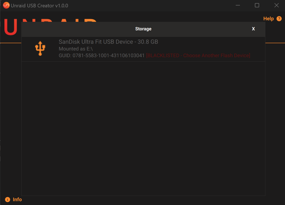

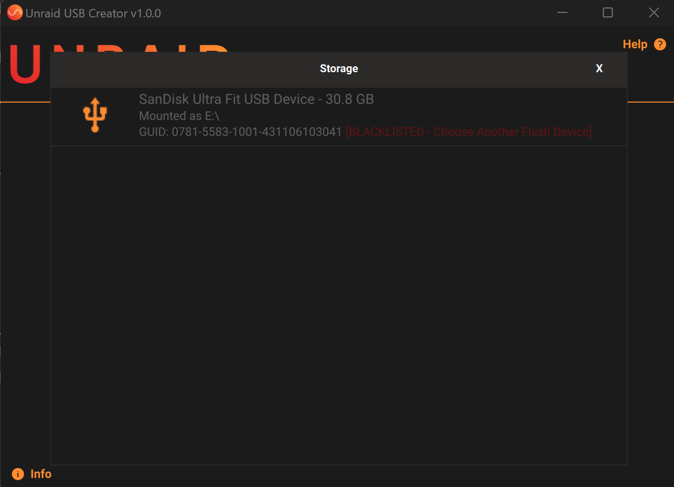

August 3, 20242 yr Hi, I find that some USB drives which I'd used for (trial) Unraid installs don't work with the Unraid USB Creator anymore. They show as blacklisted when I use the USB creator now, though they worked just fine earlier - why? My licensed Unraid is now on another USB, which I am trying to compare performance with because I have slow boot times. Isn't there a way to manage this so we can reuse disks post trial for legitimate reasons? Would appreciate feedback on how this can be addressed. It's a bit annoying to have to get another USB (?) just to test this. Thanks Edited August 3, 20242 yr by kman13 grammar
December 6, 20241 yr Did you get any feed back on this? I too have an old USB that I want to reload with a current unRaid so I can test a potato server to see if it will work with unRaid. But I too get this error. HELP.
December 6, 20241 yr Community Expert Could be an issue with the USB tool, try a manual install: https://docs.unraid.net/unraid-os/getting-started/manual-install-method/
December 7, 20241 yr No solution yet - I got tied up with work and didn't manage to get back to my server in the last few months. Hoping that I can get in touch with them over the next few weeks and get an Xmas reprieve on those USB drives. Have 3 now that have passed the end of trial before I could get any time to restore my Unraid 🤦♂️ Edited December 7, 20241 yr by kman13
