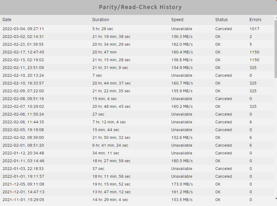

I'm starting to think something else is wrong.  I always have parity errors now, and the server is rebooting randomly.  I always run the parity check to fix errors as well.  Currently doing another parity check, and its showing 398 errors so far.

Have you checked your memory ?
Can't get through a parity check without a reboot.  Going to run memtest now.
