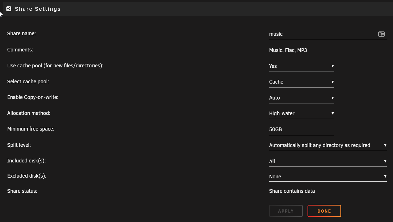

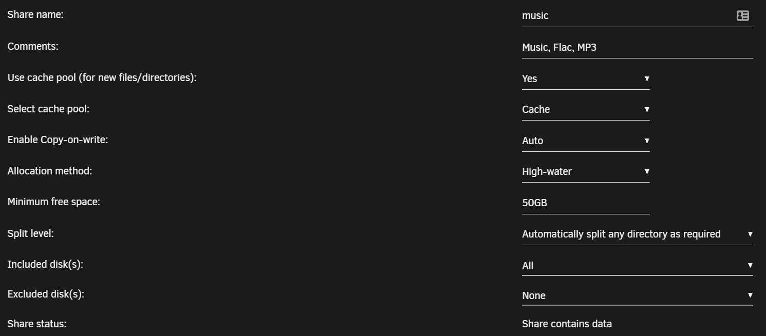

Some time ago I setup Lidarr to a subdir that might have broken the split level I use for music? (All the other split levels has ben working for years)
Looking at the path I have:
music\Albums new\Artist\album\files

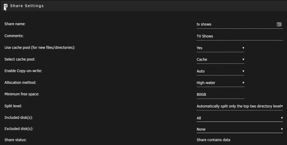

The share is set like this:
Looking at the cfg for shares I have cfg from when I imported data from my Synology NAS years ago

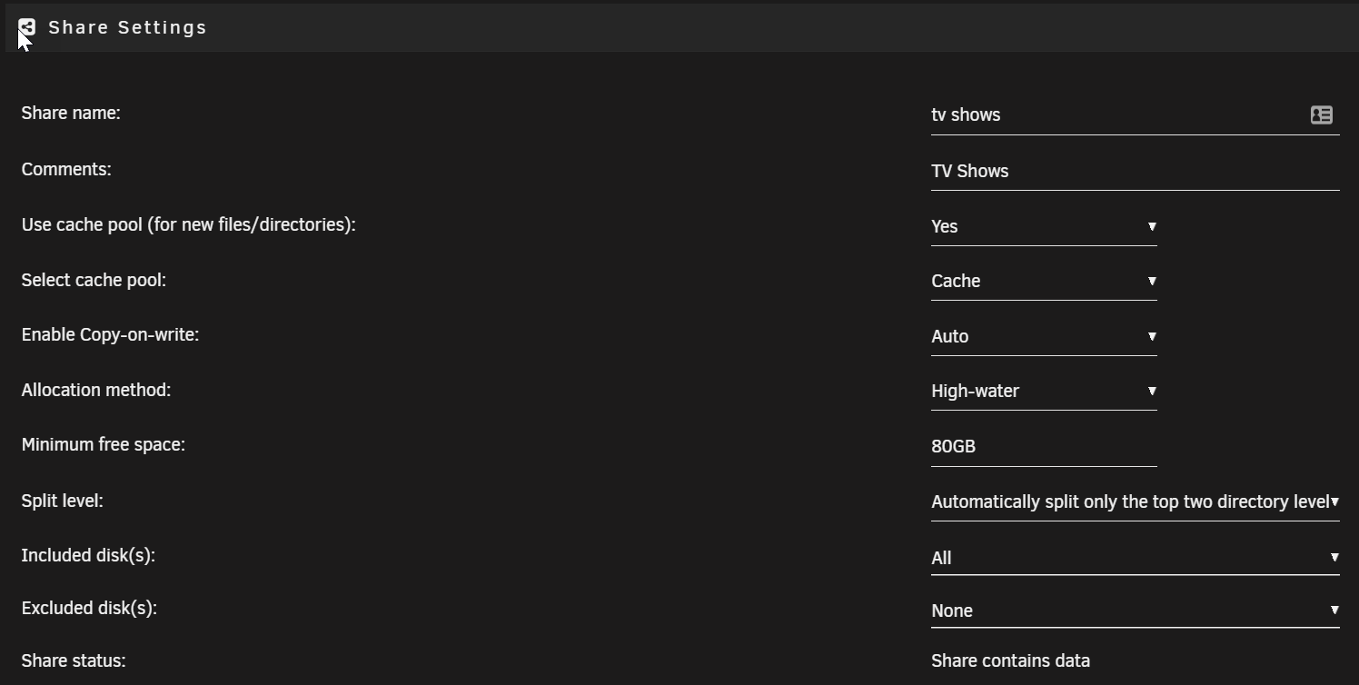

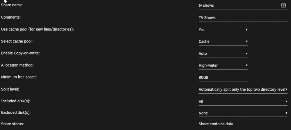

With a Split Level of 2 then once the ‘Magnum P.I. (2018) [tvdb-350068]’ folder (which is at level 3) is created on any drive then all content for that folder is forced to that drive regardless of whether there is space for it.
So the split level for TV shows should be set at level 3?

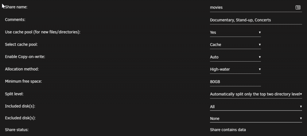

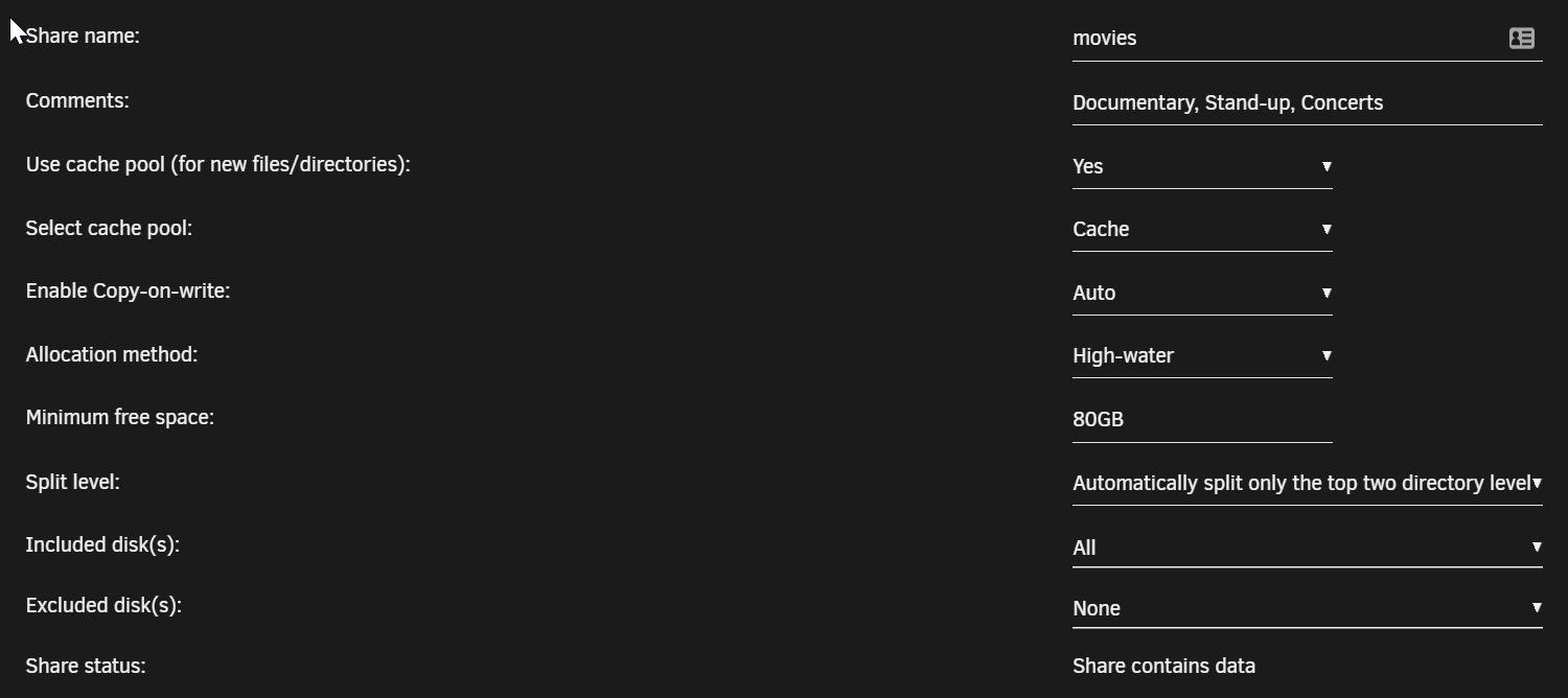

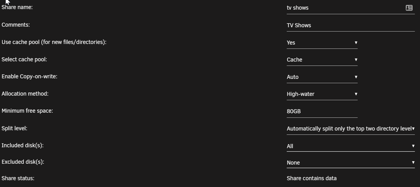

I have looked at all the shares and they are the same split level as when I started running Unraid
the 3 important shared folders and the one that the cache drive is trying to move folders from is these with paths
Just luck I havent seen this before I guess?
Any other of these that should have a different spli level?
\music\Albums new\Mudvayne\Album (2000)\CD1\files
\movies\Movies\title (2001)\Filenames
\tv shows\TV Shows\Title (2022)\Season 01\files
There is no right-or-wrong answer as it can vary by user.   Work out how many folder levels (including the share name) you want to allow to exist on more than one drive and set the Split Level to be at least that value.
