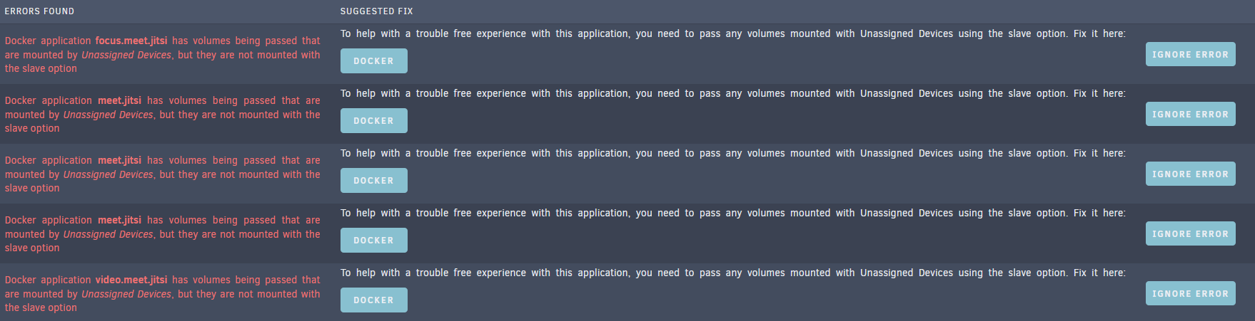

How do I change Access mode to read/write-slave for docker-compose containers?
I have my appdata folder on an unassigned disk.  For all my unraid templates, this is not a problem because I simply change the template to set the appdata folder to read/write slave.  But I recently installed Jitsi using docker compose with Spaceinvaderones guide.  Now Im getting these errors in the fix problems plugin:
If I click the docker button it just takes me to the docker tab, but there's no way to make any edits from there for these jitsi containers.
This question probably belongs in the thread about this guide in the guide section of the forum. That said I think the solution should be easy enough. I believe you just need to  edit your compose.yml file and add the slave option to the end of your volume mount lines.
:rw,slave
or
:ro,slave
If the compose file is using the long syntax for the mounts rather than the short then things are a bit different. Either way a reference to the mount syntax is here https://docs.docker.com/compose/compose-file/compose-file-v3/#volumes
I tried adding :rw,slave after volume:  so it looked like this
volume: rw,slave
.... but it didnt seem to work.  I  can't really make heads or tails of anything on that webpage, so I'm not sure if I'm using long or short syntax?  Here is my docker-compose.yml file:
Wait after looking at it further, I think I need to edit the lines like
${CONFIG}/web:/config:Z
so it looks like
 ${CONFIG}/web:/config:rw, slave
 Would that be right?  I read about that Z option but couldnt understand it.  Is it not important?

Correct those are the actual short syntax volume mount lines.
I made the changes, but the Unraid error persists.  I even tried running
docker-compose down -v
and then
docker-compose up -V -d
to ensure the volumes where remade but without success.  Unraid is still reporting the error.
I try running
docker inspect meet.jitsi
and then see this
 "Mounts": [
                "Type": "bind",
                "Source": "/mnt/disks/NVME/appdata/jitsi/jitsi-meet-cfg/web/crontabs",
                "Destination": "/var/spool/cron/crontabs",
                "Mode": "rw",
                "RW": true,
                "Propagation": "rprivate"
So it doesnt look like entering rw,slave in my .yml file is doing anything.
Edited by 007craft
All warnings from FCP are not necessarily anything wrong per se.  If you're having absolutely zero issues, then ignore it and go about your business.
After spending several hours trying to tourbleshoot this I think thats what I will do, just ignore the warnings.
Because I change my .yml file for example from:
- ${CONFIG}/jicof:/config:rw
To
- ${CONFIG}/jicofTESTING:/config:rw,slave
 and the volume mapping definitely changes to the new location of jicofTESTING but the mode remains the same, as rw.  And reading docker volume documentation I see that the rw setting is actually the default setting, so when my original .yml file had the Z option, it also didnt apply that, and just alwaysvdefaulted to the RW setting.
It seems just ignoring this does not cause me a problem because even tho jitsi is supposed to have the z mode setting (So it can share volume mappings between containers) it doesn't actually appear to need it, as it is still working.  I just hope this isint a future problem for another application I may download on unraid that uses docker-compose.
Try changing the version of your compose file from 3 to 3.3.
Also just a point of order these are not volumes per se, they are bind mounts to folders. I dont think the -V option for up and down are necessary when talking about bind mounts.
