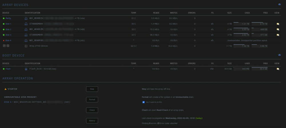

One of my HDD died, I RMA'ed it and got a new one (same make/model). I received the replacement part and now, I can't re-add to my array..
1. Unraid detects the drive, so I add it back in the position of the missing drive. At this stage, I see my Disk 4 is "Not installed" and a Dev 1 disk is Unassigned (the new disk without FS).
2. I must stop the array, to add the disk.
3. I select my unassigned disk to Disk 4, then click "Start" on the array.
4. The drive is added, but I get a message telling the disk is unmountable and I have the option the format the disk. When I click "Yes", through the warning, the drive seems to starts formatting, but it does not. I get back the the GUI with the same state.
Is there any way I could look to see if the problem is hardware or software related?  At this point, I have no clue where to look.
Could I do some equivalent commands in the CLI to format the new HDD?
Some other test I did: I changed the physical connection within my computer. Swapping disks on the controllers. But, no matter what I try to it does not seems Unraid can format the disk using the GUI.
Here is my current state. This may gives clue to people that would like to help me.
Basically replaced WD-PURZ with another WD-PURZ.  I expected the system to automatically "recreate/read" the drive without any intervention. This disk "died", so I wasn't able to do a proper shutdown/removal of the array. I followed these steps the best I could.

@itimpi: I'm sort of confused... It's a new disk, so there is no FS on it. I may have a big misunderstanding of how Unraid works, but Unraid should be able to auto-fix this. A disk died, I put a replacement (unformatted) drive of the same or bigger size and the magic should happen.
I honestly don't know which part of the document you shared I should follow to try to make my new drive working or to understand if it's an hardware or a software issue. I may have a DOA, but how I can tell?

@itimpi: Humm... I do really suspect a DOA drives. No matter what I try to do, I just can't get anything from Unraid. And I just noticed the SMART reports already contains errors for a drive that is only a couple hours old, this is suspicious.

@itimpi: Here it is... I already have opened a ticket with Western Digital.
And frankly, I don't think I have break anything in Unraid. The GUI still mention that I have 27.9GB of data on the "phantom/missing" drive. Crossing fingers.
