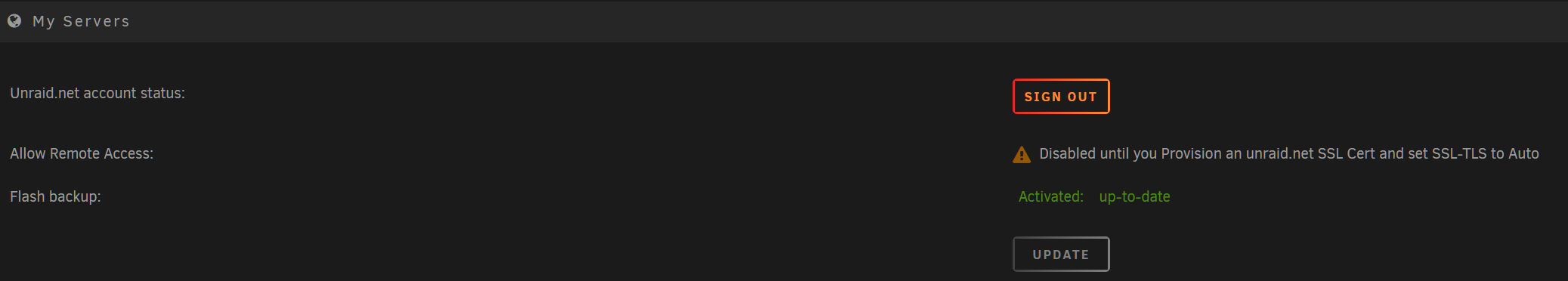

Post a screenshot of Settings - Management Access - My Servers (mark out IP/port)
16 hours ago, trurl said:
There are no changes to flash except when you make a configuration change in the webUI. Whether you choose to make a backup after each change is up to you. Or use My Servers as mentioned.
I checked again and indeed it seems to be working now. Strange.
