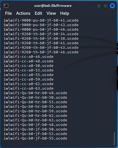

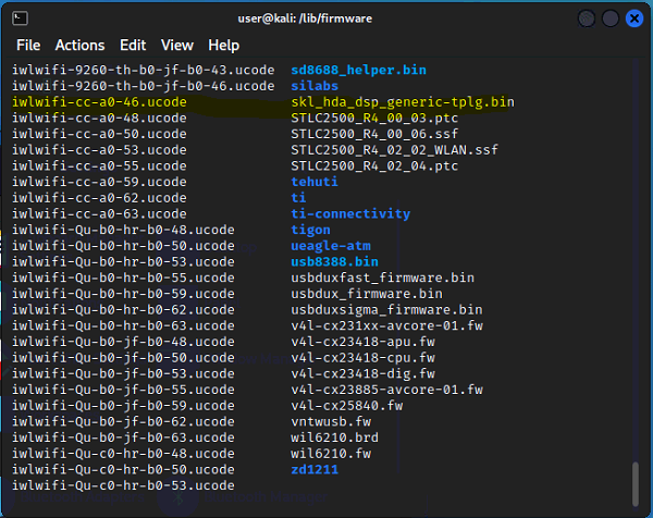

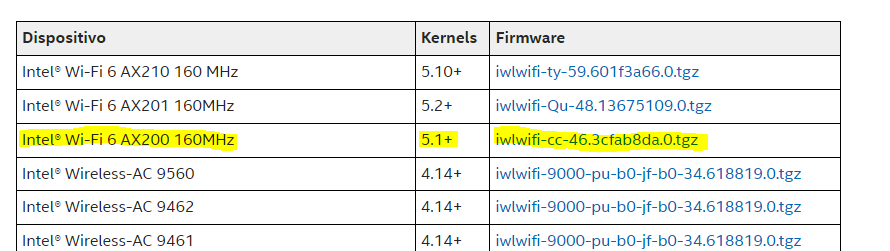

already inside the virtual machine in the path /lib/firmware, the drivers of the network card are seen according to the intel page
https://www.intel.la/content/www/xl/es/support/articles/000005511/wireless.html
$ cd /lib/firmware
$ ls

Already run these commands
$ apt-get update
$ apt-get upgrade
$ apt update
$ apt upgrade
Also run this, but it doesn't work
$ apt-get install --target-release=buster-backports firmware-iwlwifi
Reading package lists... Done
E: The value 'buster-backports' is invalid for APT::Default-Release as such a release is not available in the sources
Run this, but package was already installed
$ apt-get install firmware-iwlwifi
Building dependency tree... Done
Reading state information... Done
firmware-iwlwifi is already the newest version (20210818-1+kali2).
0 upgraded, 0 newly installed, 0 to remove and 1 not upgraded.

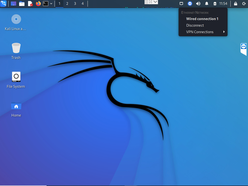

Wi-Fi networks do not appear
$ iwconfig
lo        no wireless extensions.
eth0      no wireless extensions.

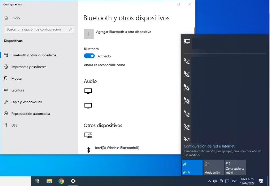

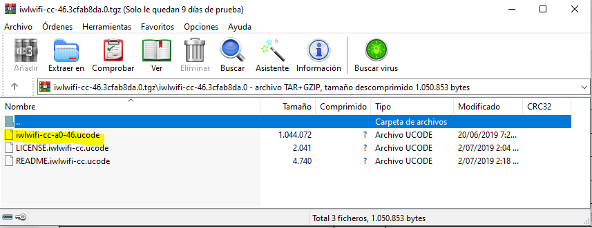

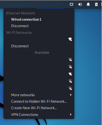

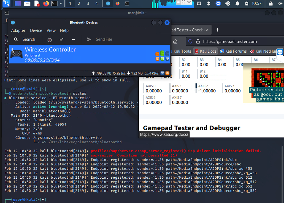

  • after doing this.   i did this again, step by step     The image is edited, it is working correctly.   $ rfkill   ID TYPE DEVICE SOFT HA
  • Check this video:   worrying voice but should help

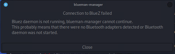

  • bluetooth now works great.     only this output appears. I don't know if I should do something with this Feb 12 10:50:32 kali bluetoothd[2149]: profiles/sap/server.c:sap_server

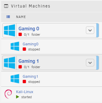

This is the configuration of my virtual machine

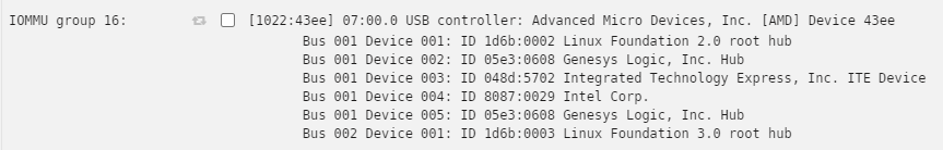

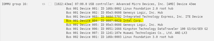

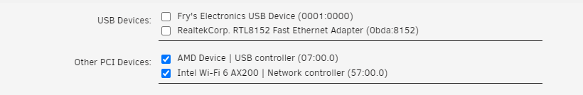

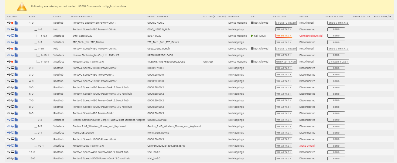

My thought is that since it's a composite device (wifi+bluetooth) you need to passthrough also the bluetooth part: this can be tricky, since the bluetooth is attached to usb.
Best option is to passthrough to the vm the wifi+the entire usb controller (not the single device) to which bluetooth is attached; however it seems you attached the bluetooth to the same controller where you have the unraid usb pendrive, so it cannot be passed through...
Also follow SimonF link to prevent unraid from using the bluetooth.

I also wanted to share this, I see that the bluetooth is in another USB tree. I don't know if I'm correct.
@ghost82
Not so expert, but I cannot find from your screenshot what usb port belongs to which usb controller.
From this screenshot:
you can clearly see that both 8087:0029 (bluetooth) and the kingston datatraveler (unraid) are connected to the same controller at 07:00.0.
If you have a spare usb pendrive attach it to different ports and see to which usb controller it attaches; once you find that it attaches to a different controller, move the unraid pendrive to that port, boot, remove the bluetooth device passthrough, attach to vfio at boot the usb controller to which the bluetooth is attached and passthrough in your vm the entire usb controller.
Edited by ghost82
I am going to move the USB, but I have no idea how to make the full pass of the USB where the bluetooth is
Once you move the unraid pendrive to a different usb controller you can share you diagnostics file to get more help on setting it.
However, once you attach that usb controller to vfio (the one to which the bluetooth is attached) you should see it under or above the wifi 6 device, just put a check on it to pass it through (obviously you wont find any usb device in the "USB devices" that are attached to that controller, because all that devices will be automatically be in the vm):
By "attaching to vfio at boot" I mean put a check for iommu group 16 (now it's greyed out because it can't be passed through, but it will become available once you move the unraid pendrive to a different controller)
Note that you have other devices attached to that controller, so move them too if you need them in the host.
Edited by ghost82
LOL, it seems that I had already done this process to pass the WiFi device, thanks for the patience.
Now I understand th e concept you were referring to. Thanks.
switch PCIe ACI override
but I do not separate the bluetooth
NOTE: when I checked the VFIO pool and restarted the server, I forgot to unmap the virtual machine's bluetooth. and I had to go through the process of unchecking the pool, rebooting, going back to the virtual machine and unchecking bluetooth. redial the group and reboot again.
All this because when I already had the group marked, it would no longer let me modify the virtual machine to assign the VFIO group.
I could have saved myself all this if I knew how to modify the XML, but I'd rather be sure.
After marking the group the devices disappeared and this appeared
Now I see this in the virtual machine
I'm going to do tests in kali linux
VFIO-PCI Log.txt server-diagnostics-20220212-1000.zip XML_Virtual_Machine without _bluetooth.txt XML_Virtual_Machine with _VFIO.txt
Feb 12 10:50:32 kali bluetoothd[2149]: profiles/sap/server.c:sap_server_register() Sap driver initialization failed.
Feb 12 10:50:32 kali bluetoothd[2149]: sap-server: Operation not permitted (1)
Feb 12 10:50:32 kali bluetoothd[2149]: Endpoint registered: sender=:1.36 path=/MediaEndpoint/A2DPSink/sbc
Feb 12 10:50:32 kali bluetoothd[2149]: Endpoint registered: sender=:1.36 path=/MediaEndpoint/A2DPSource/sbc
Feb 12 10:50:32 kali bluetoothd[2149]: Endpoint registered: sender=:1.36 path=/MediaEndpoint/A2DPSink/sbc_xq_453
Feb 12 10:50:32 kali bluetoothd[2149]: Endpoint registered: sender=:1.36 path=/MediaEndpoint/A2DPSource/sbc_xq_453
Feb 12 10:50:32 kali bluetoothd[2149]: Endpoint registered: sender=:1.36 path=/MediaEndpoint/A2DPSink/sbc_xq_512
Feb 12 10:50:32 kali bluetoothd[2149]: Endpoint registered: sender=:1.36 path=/MediaEndpoint/A2DPSource/sbc_xq_512
Feb 12 10:50:32 kali bluetoothd[2149]: Endpoint registered: sender=:1.36 path=/MediaEndpoint/A2DPSink/sbc_xq_552
Feb 12 10:50:32 kali bluetoothd[2149]: Endpoint registered: sender=:1.36 path=/MediaEndpoint/A2DPSource/sbc_xq_552
bluetooth works fine on kali, and works after reboot. Thank you very much for the video.
I'm still without Wifi, but I have a feeling that this is on the right track.

I currently have 3 virtual machines
2 windows
1 kalilinux
A while ago I assigned bluetooth and wifi to one of the windows machines and took this screenshot confirming that they work.
I don't understand when they refer to boot issues.
Do I have to make any configuration in the BIOS of the virtual machines?
or in the physical machine BIOS?
Or do you mean if I had two partitions in the "Kali" virtual machine with two operating systems? (This is not the case)
I already did the test of turning on the windows virtual machine with wifi and bluetooth. turn it off, and turn on kali linux

53 minutes ago, SimonF said:
Have you installed Bluez?
sudo apt install bluez, Also have you set the Daemon to start if loaded?
I dont use Kali so not sure what is required.
https://www.kali.org/tools/bluez/
Also may want to check rfkill
https://thehacktoday.com/how-to-install-and-use-rfkill-in-kali-linux/
@SimonF I did not have any bluetooth driver installed, nor the services running. With the video that I put @ghost82 , those configurations were made, the bluetooth is working very well.
Again, thank you both very much for helping me. It seems that there is little left to finish configuring this.
