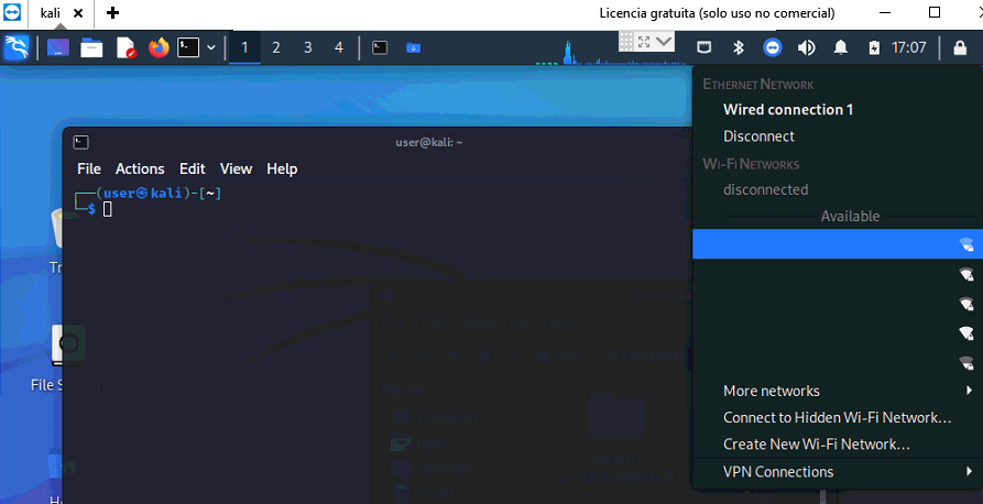

Does anyone know how to pass through the Wi Fi 6 ax200 network card to a virtual machine with Kali Linux OS?
Solved by JhonScript

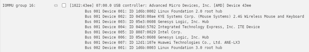

  • after doing this.   i did this again, step by step     The image is edited, it is working correctly.   $ rfkill   ID TYPE DEVICE SOFT HA
  • Check this video:   worrying voice but should help

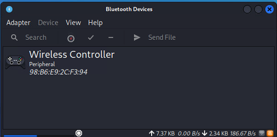

  • bluetooth now works great.     only this output appears. I don't know if I should do something with this Feb 12 10:50:32 kali bluetoothd[2149]: profiles/sap/server.c:sap_server
2 minutes ago, JhonScript said:
$ rfkill list all
0: hci0: Bluetooth
        Soft blocked: no
        Hard blocked: no
NOTE: execute this in Kali Linux, because in UNRAID it does not execute the command
I don't know if something about wifi should appear here.

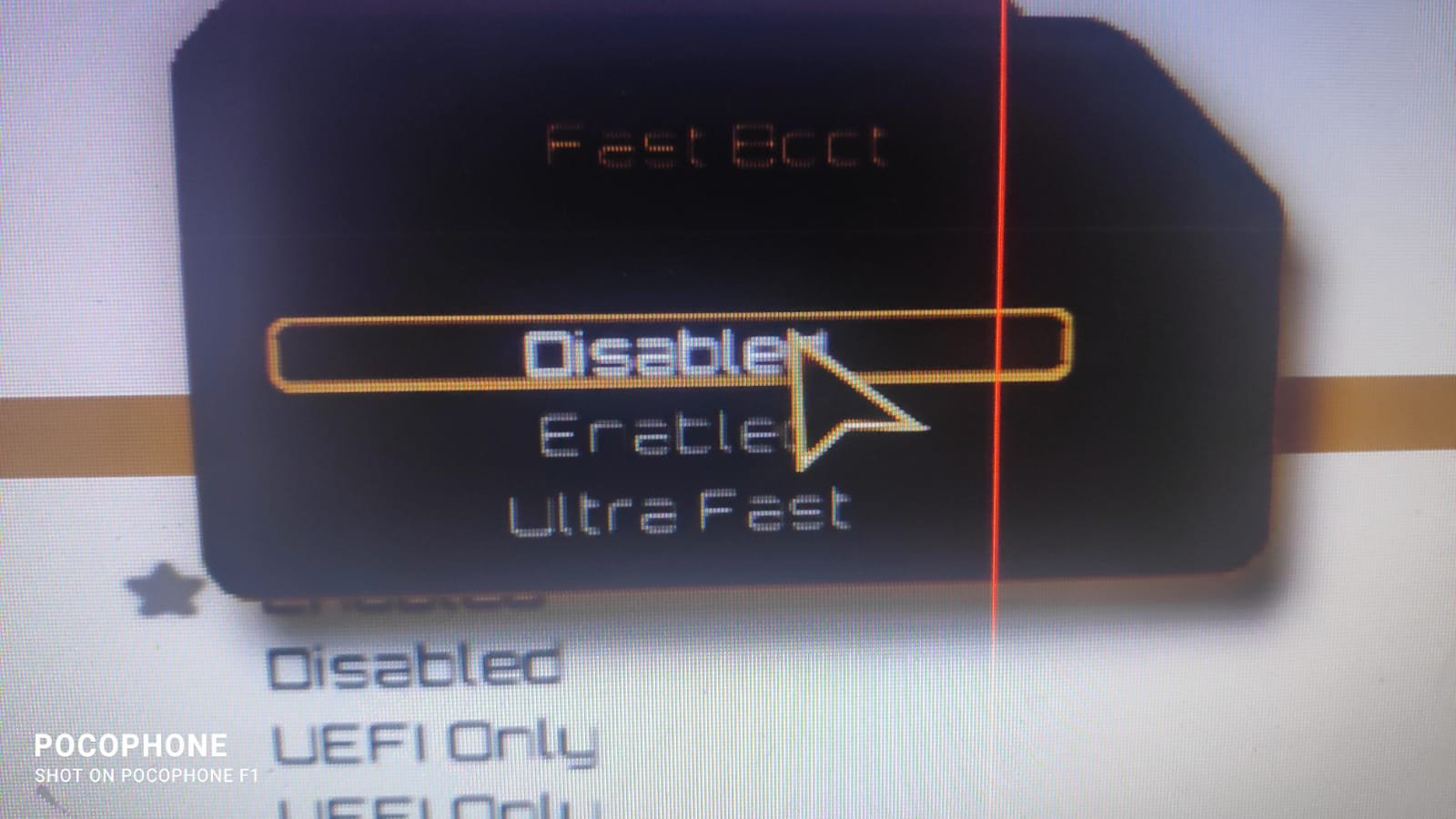

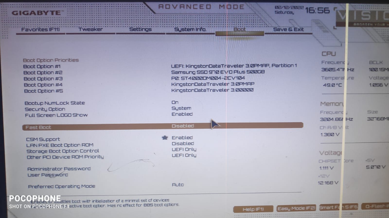

Shutdown your pc.
Boot to your pc bios (not the vm bios), disable fast boot if it's enabled and apply changes, shutdown.
Unplug power chord and wait 2-3 minutes.
Boot unraid and run the linux vm, do not start any windows vm before.
See if you get wifi.

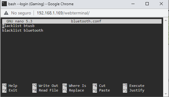

Also did you blacklist these as will be reloaded if you reboot unraid.
just run this line, because the path "/boot/config/modprobe.d/" already exists.
# echo -e 'blacklist btusb\nblacklist bluetooth' > /boot/config/modprobe.d/bluetooth.conf
and when reviewing the file with the "nano" command, it looked like this.

Shutdown your pc.
ok... I'm going to do it, I'm already getting scared :)

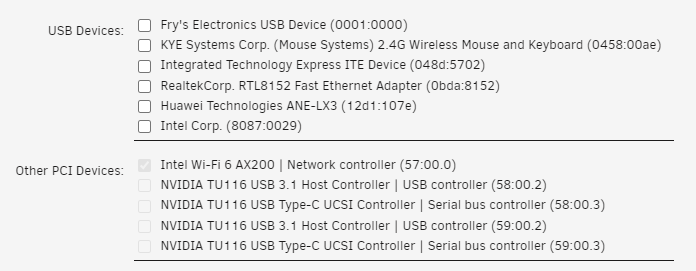

My thought is that since it's a composite device (wifi+bluetooth) you need to passthrough also the bluetooth part: this can be tricky, since the bluetooth is attached to usb.
Best option is to passthrough to the vm the wifi+the entire usb controller (not the single device) to which bluetooth is attached; however it seems you attached the bluetooth to the same controller where you have the unraid usb pendrive, so it cannot be passed through...
Also follow SimonF link to prevent unraid from using the bluetooth.

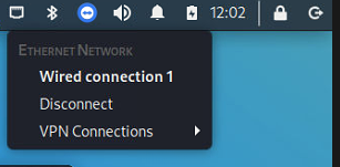

I already did the whole procedure but I continue without Wi Fi, bluetooth continues to work
I forgot to mention, fast boot was always disabled

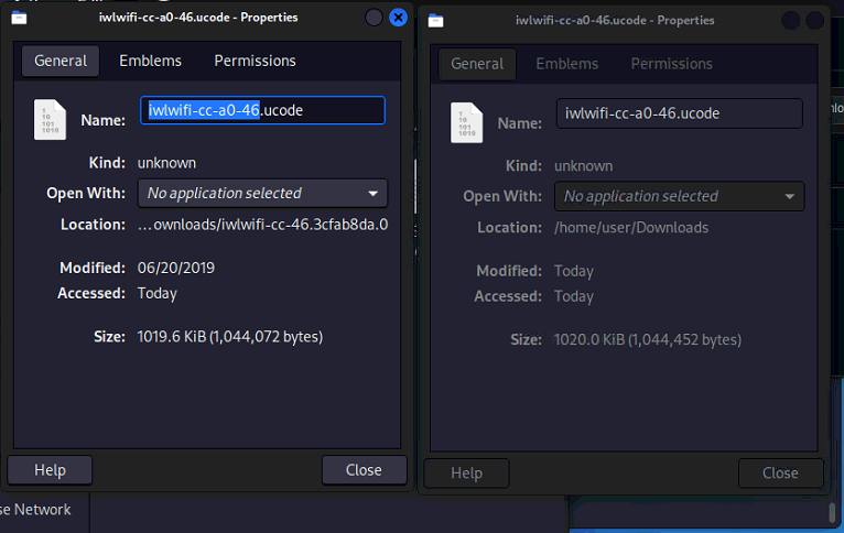

I see that the newest version of the firmware you have in /lib/firmware/ is a0-63.
If I'm not wrong the latest available version should be a0-68.  <-- Wrong, they are completely different firmwares, not updates.
Maybe the issue is a faulty firmware.
Try to clone the linux-firmware repo and copy iwlwifi-cc-a0-68.ucode into /lib/firmware, then try to load it instead of a0-63. <-- Non sense. the firmware is for a different device.

Maybe the issue is a faulty firmware, fixed with newer updates.
Try to clone the linux-firmware github repo and copy iwlwifi-cc-a0-68.ucode into /lib/firmware, then try to load it instead of a0-63.
:(, I don't know how to clone the repository of iwlwifi-cc-a0-68.ucode, i only found this repo https://github.com/thesofproject/linux-firmware/blob/master/iwlwifi-cc-a0-46.ucode
I found this page but I'm not sure how to download the file. in the lower right corner there is a "txt" link, it downloads a file and I can change the extension to ucode. I don't know if that is the correct way.
https://chromium.googlesource.com/chromiumos/third_party/linux-firmware/+/master/iwlwifi-cc-a0-68.ucode

3 minutes ago, JhonScript said:
It seems that they have different weight, I will do tests.
copy the new file, restart the kali.
I don't change anything. :(

Rename file 46 to 66 and copy file "66" to /lib/firmware folder, run dmesg command and get this output
[    5.491948] iwlwifi 0000:04:00.0: firmware: direct-loading firmware iwlwifi-cc-a0-66.ucode
[    5.491968] iwlwifi 0000:04:00.0: Found debug destination: EXTERNAL_DRAM
[    5.491969] iwlwifi 0000:04:00.0: Found debug configuration: 0
[    5.492245] iwlwifi 0000:04:00.0: loaded firmware version 46.177b3e46.0 cc-a0-66.ucode op_mode iwlmvm
[    5.651527] iwlwifi 0000:04:00.0: Detected Intel(R) Wi-Fi 6 AX200 160MHz, REV=0x340
[    5.749474] iwlwifi 0000:04:00.0: retry init count 0
[    5.749507] iwlwifi 0000:04:00.0: Detected Intel(R) Wi-Fi 6 AX200 160MHz, REV=0x340
[    5.849701] iwlwifi 0000:04:00.0: retry init count 1
[    5.849728] iwlwifi 0000:04:00.0: Detected Intel(R) Wi-Fi 6 AX200 160MHz, REV=0x340
[    5.936719] iwlwifi 0000:04:00.0: retry init count 2
After loading the driver it keeps trying to detect the wifi card.
Edited by JhonScript
after doing this.
5 hours ago, ghost82 said:
That's really strange :)
Shutdown your pc.
$ rfkill
ID TYPE      DEVICE      SOFT      HARD
 0 bluetooth hci0   unblocked unblocked
 1 wlan      phy0   unblocked unblocked
$ iwconfig
lo        no wireless extensions.
eth0      no wireless extensions.
wlan0     IEEE 802.11  ESSID:"EXAMPLE"
          Mode:Managed  Frequency:2.437 GHz  Access Point: FF:FF:FF:00:00:00
          Bit Rate=26 Mb/s   Tx-Power=22 dBm
          Retry short limit:7   RTS thr:off   Fragment thr:off
          Power Management:on
          Link Quality=70/70  Signal level=-24 dBm
          Rx invalid nwid:0  Rx invalid crypt:0  Rx invalid frag:0
          Tx excessive retries:0  Invalid misc:7   Missed beacon:0
sudo dmesg | grep iwl
[    3.970022] iwlwifi 0000:04:00.0: firmware: direct-loading firmware iwlwifi-cc-a0-66.ucode
[    3.970035] iwlwifi 0000:04:00.0: Found debug destination: EXTERNAL_DRAM
[    3.970036] iwlwifi 0000:04:00.0: Found debug configuration: 0
[    3.970174] iwlwifi 0000:04:00.0: loaded firmware version 46.177b3e46.0 cc-a0-66.ucode op_mode iwlmvm
[    5.769813] iwlwifi 0000:04:00.0: Detected Intel(R) Wi-Fi 6 AX200 160MHz, REV=0x340
[    5.781915] iwlwifi 0000:04:00.0: Applying debug destination EXTERNAL_DRAM
[    5.782199] iwlwifi 0000:04:00.0: Allocated 0x00400000 bytes for firmware monitor.
[    5.871900] iwlwifi 0000:04:00.0: Detected RF HR B3, rfid=0x10a100
[    5.931647] iwlwifi 0000:04:00.0: base HW address: 8c:c6:81:ef:ba:a5
[    7.062842] iwlwifi 0000:04:00.0: Applying debug destination EXTERNAL_DRAM
[    7.206552] iwlwifi 0000:04:00.0: FW already configured (0) - re-configuring
[    7.239315] iwlwifi 0000:04:00.0: Applying debug destination EXTERNAL_DRAM
[    7.384031] iwlwifi 0000:04:00.0: FW already configured (0) - re-configuring
I don't understand why this happens. There must be a way to force it to look for file 46 directly and not have to do this. but well it works and I'm happy.
I thank you very much for the time you spent @ghost82, @SimonF.
I hope if someone has come across this. at least this solution will work.

For the kernel that wifi card can be used with that range of firmwares.
If you delete all iwlwifi-cc-a0-XX.ucode in your /lib/firmware/ and put only iwlwifi-cc-a0-46.ucode (without renaming it), the kernel should start looking for a0-66 going down till it finds a file in the range a0-66 --> a0-39. And I'm quite sure it will load the correct a0-46, because it's in the range of allowed firmwares and it's the only one available in /lib/firmware/.
If I were you, I would go this way, delete all, and put only a0-46.
If you stick with the "firmware renamed solution", remember that if you update the linux-firmware package (if you have it installed), your renamed firmware could be overwritten (replaced with the real a0-66) and your wifi won't work again, if it will be the case, just repeat the steps you did.
Devices like this have the firmware loaded in the device ram during boot, if a wrong firmware is wrongly loaded you may need to power cycle it to be able to load another firmware on it.
Edited by ghost82
this makes sense, regarding the procedure of turning off and disconnecting the power supply from power.
Got it, I'm going to work on that solution today.

I tell you that during the day I did the following:
PCIe ACS override: Multi-function
I removed bluetooth.conf file from path /boot/config/modprobe.d/
I created a new virtual machine with O.O Kali Linux and just passed the WiFi device which was marked for VFIO on boot
NOTE: With the creation of a new machine we would discard all the configurations that were made within the virtual machine
Everything works within Kali.
The image is edited
The screenshots show that the bluetooth (Intel Corp. (8087:0029)) is not found, but I already verified that I can associate it to the virtual machine without having to associate the entire IOMMU group or another different device

1. Changed USB port to UNRAID OS Bootable USB
2. have gone through the process of shutting down the physical machine and disconnecting it from power for 2-3 minutes
3. have booted the physical machine and run the Kali Linux virtual machine without running any other virtual machines that make use of the WiFi device
I'm guessing you also need to have Fastboot disabled in the BIOS of the physical machine. (In my case it was always disabled)
In the next few days I will rule out the need to move the UNRAID OS boot usb to another USB port.
I don't know if I missed something we did. but I think that would be the summary until I drop point number 1, God willing :).
