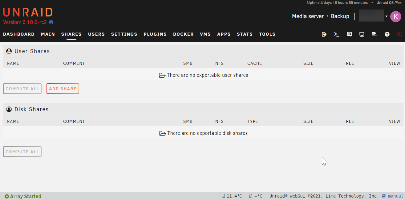

I have no shares present on 1 of 2 servers. The server that has no shares is my backup server. I just started backup up to this server using Duplicati the 2 days ago. Dockers obviously are not started. I have attached my diagnostics and have not rebooted the server in case something else is needed. Let me know if you can help me. Thank you.

There's a problem with the cache fileystem, and since data corruption was being detected suggest running memtest before re-formatting it.
OK. Running memtest now. How bad is this? Is all my data lost? If I find an issue with the RAM and fix it, will I be able to restore my shares? Like I said this is my backup server, other than time, I really have not lost anything critical. It is just that Crashplan will take a few weeks to backup to the cloud.
Unlikely, once you fix/re-format that filesystem shares should come back, there could be some data corruption though if there really is bad RAM or other hardware issue.
I did have 2 DIMMS bad. Once I removed that pair, the other pair tested fine. After bringing the system back up, all the shares reappeared as if nothing happened. Thank you for the help. I appreciate it.
