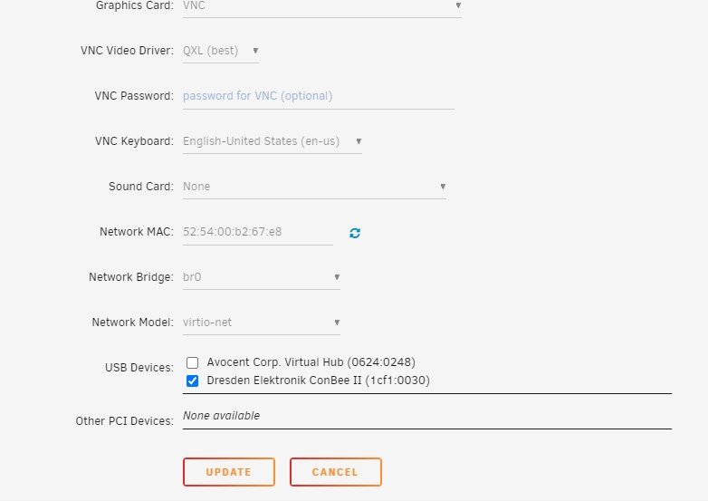

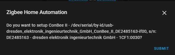

I have home assistant set up in a vm. I am unable to get my conbee ii USB stick to pass through. I am able to select it when I edit the vm but when I launch it home assistant says "fail to probe usb device".
I have also tried to add the zigbee2mqtt docker container and get a similar error when launching it.
I have tried :
ls -l /dev/serial/by-id
and the output is
lrwxrwxrwx 1 root root 13 Feb 13 12:27 usb-dresden_elektronik_ingenieurtechnik_GmbH_ConBee_II_DE2485163-if00 -> ../../ttyACM0
I am wondering if the usb device keeps disconnecting and reconnecting

ideas please as I am starting to loose my mind
