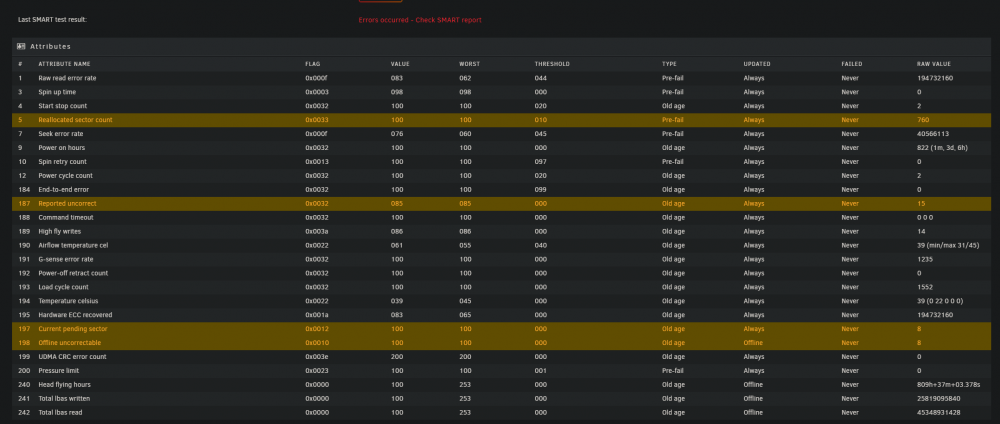

The report looks like it finished. Below are some of the rows that Unraid highlighted.
The drive is barely three months old, so I doubt it's old age, and I even pre-cleared it this time. I'm guessing it's better to go ahead and pull it, replace with the cold spare, and RMA the drive?
Those were highlighted before, you just hadn't looked there before. Also on the Dashboard page they would show warnings.
But that screenshot doesn't really say whether or not the test completed or what the result was.
Post new diagnostics.
I had not checked that section before. I didn't realize you could run extended SMART tests. Now I know.

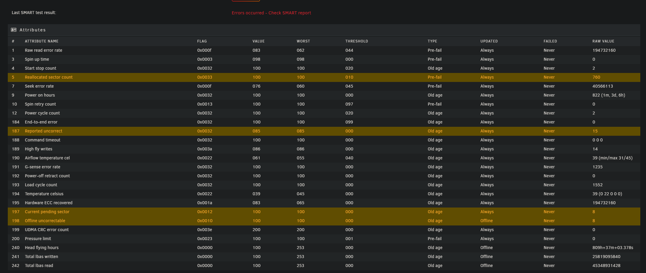

I don't think it finished. I specified that the drives shouldn't spin down, but they may have anyway. This may have been an error on my end.
zawarudo-diagnostics-20220215-2249.zip
Posted. It still shows a SMART short test of PASSED, but as I read more into the results I see the same pre-failure warnings.

14 minutes ago, banangineer said:
it finished.
SMART Extended Self-test Log Version: 1 (1 sectors)
Num  Test_Description    Status                  Remaining  LifeTime(hours)  LBA_of_first_error
# 1  Extended offline    Completed: read failure       70%       822         6931513544
