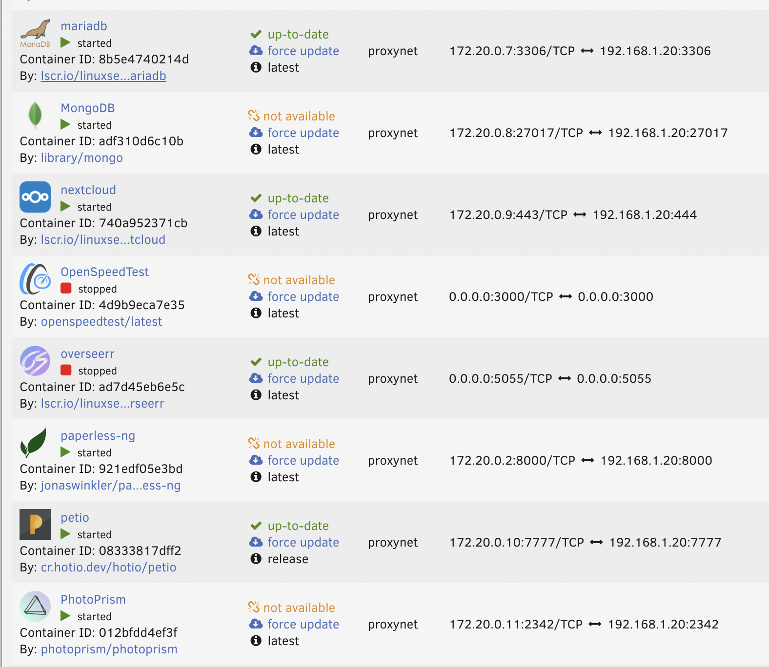

Some dockers showing that they are up to date and other not available status.  See image. The majority have unavailable status though.

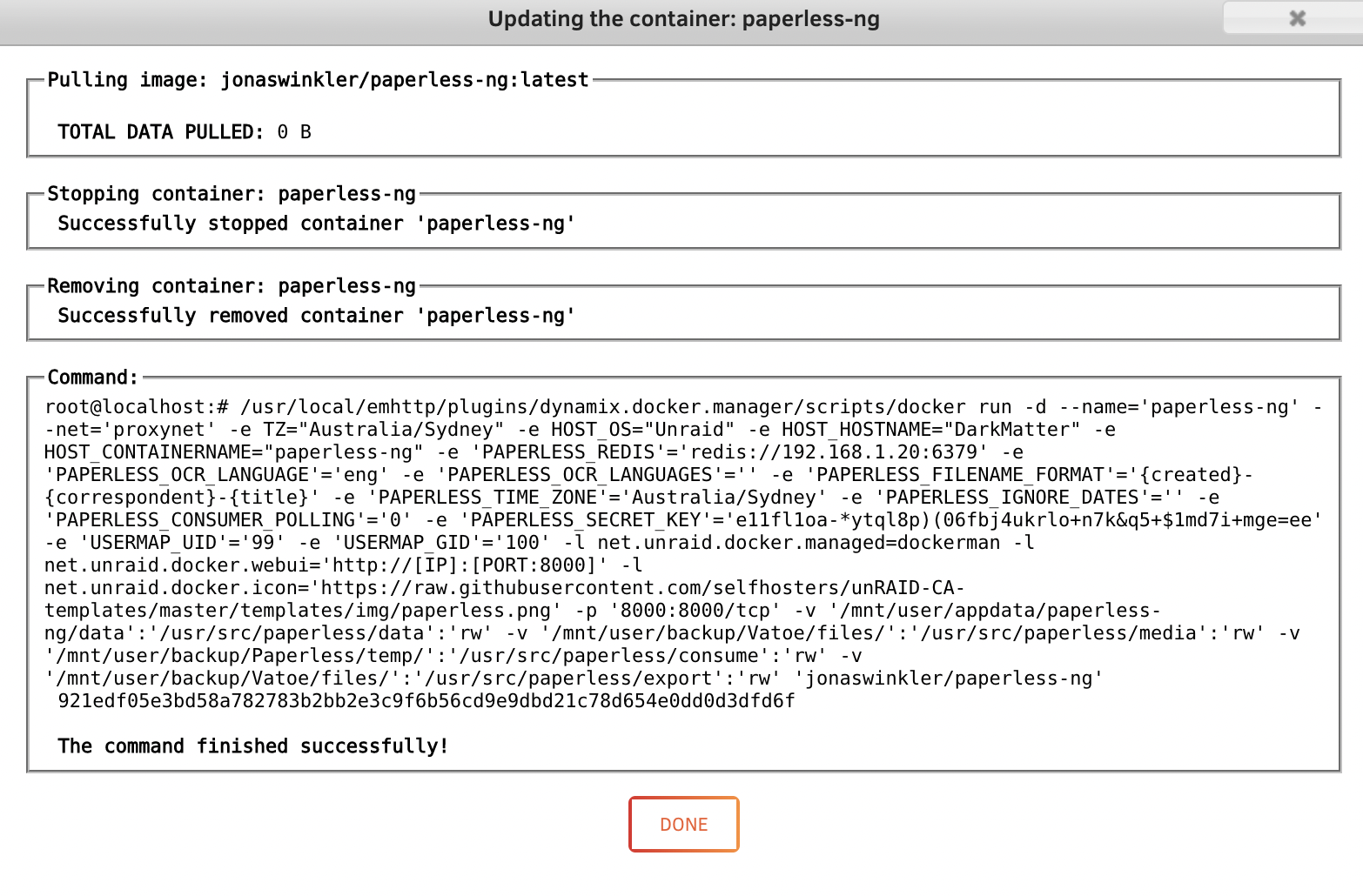

 When I try an update an 'available' one - it doesn't pull any data down but goes through the process quickly and then states;
356845276_ScreenShot2022-02-18at7_55_21am.thumb.png.35942bdfc1315fd790e00af987f49993.png

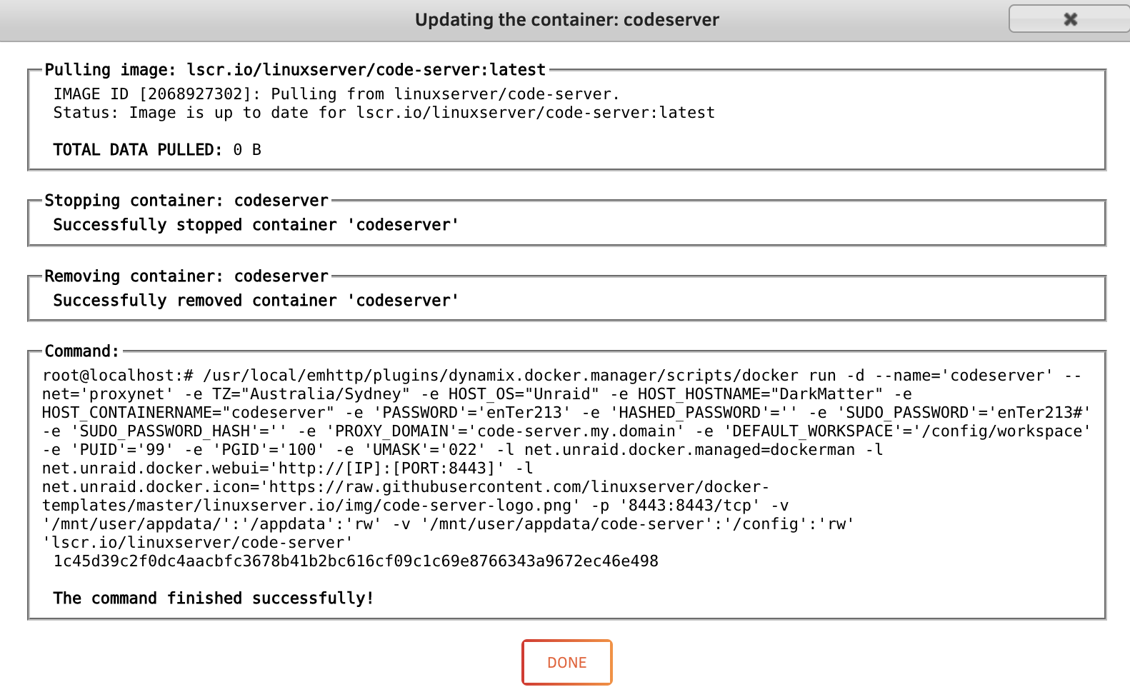

On the containers that are marked unavailable, the update process stalls for a while then it states;
923982308_ScreenShot2022-02-18at7_56_58am.thumb.png.83614104eab37d206f85d3c363c81936.png
but remains unavailable after the 'force update'.
