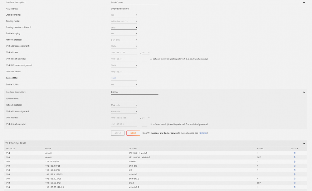

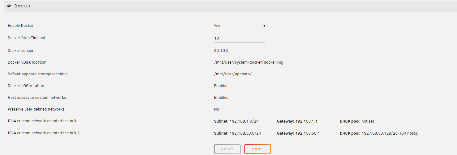

Sorry for the super late response but here are the screen shotsimage.thumb.png.2a2bbf1ca0a11a6766bf50bd0bdc43c8.png
Still not having any sucess at all, just want to reiterate i only have one nic and im trying to essentially put Homebridge on a vlan so that my other apple devices can utilize it efficiently. everytime i set it up and set the network to (custom br0.2) it wont let me access the gui, only if set to host. Thank you again for any help that you can offer!
If you only have one nic why is it bonded?
Dont know that that makes any difference just seems odd.

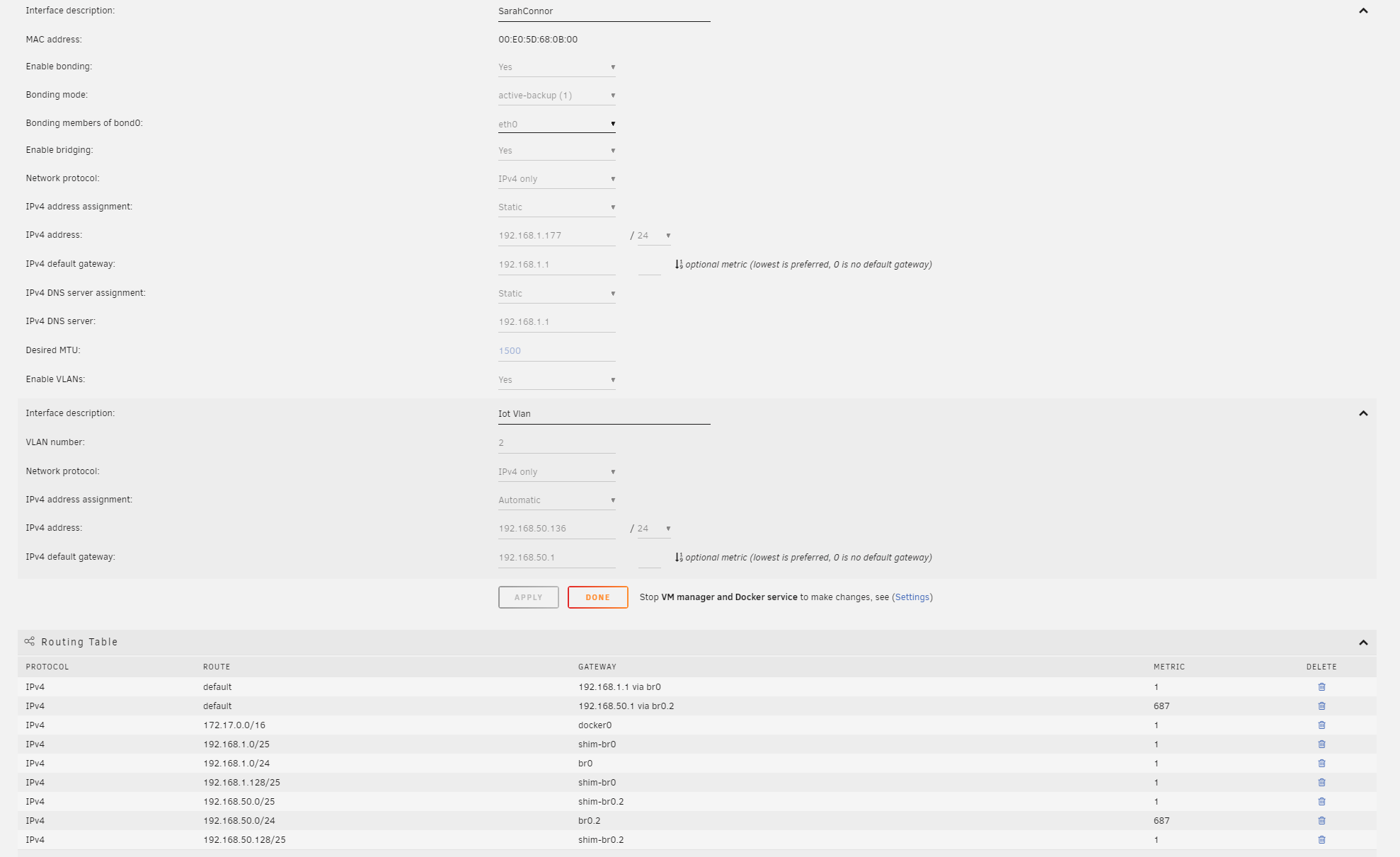

i havent changed it, but i will disable it and see if that makes a difference, anything else of note there?
Turned off bonding, but still nothing
Also, the ipv4 address assignment should be set to “none” in the vlan section.
updated, still no dice
My only other suggestion would be to check your firewall rules and ensure that access to the vlan isn’t being blocked.
