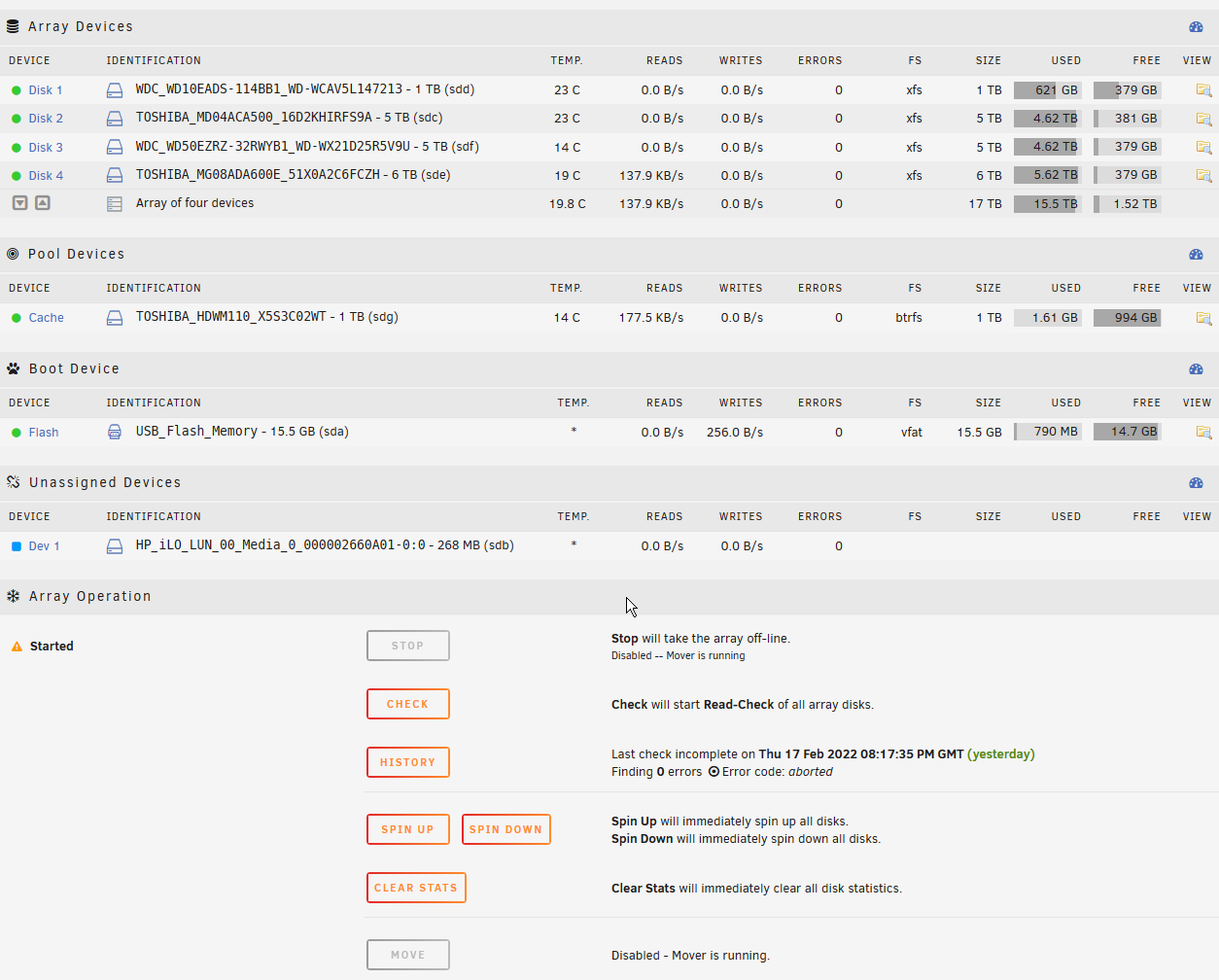

My issue: There is still 1.61GB of data that Mover wont shift, mostly appdata. I'll trigger Mover yet nothing happens. The CPU usage goes up and Mover is shown as running but all the disks are spun down after a short time and theres no data transfer activity on/from the Cache drive.

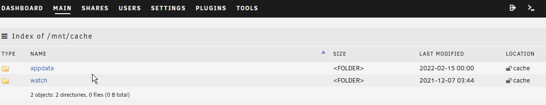

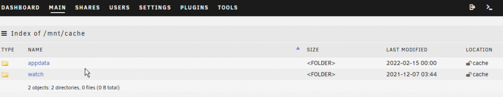

Click on the cache folder icon to view its contents and post a screenshot

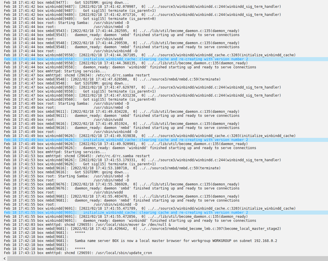

Go to Settings - Scheduler and enable mover logging, try again, and see what you get in syslog from logging mover.

A whole lot of 'does not exist' erros. Heres a snippet:
Feb 18 17:27:36 box move: move_object: /mnt/cache/appdata/Plex-Media-Server/Library/Application Support/Plex Media Server/Metadata/Artists/4/7b0dd6b057f35de6f37fbe9c3acdc902cbbe81c.bundle/Contents/_combined/posters/tv.plex.agents.music_e339639ea94575851b98389280622b981697c420 No such file or directory
Feb 18 17:27:36 box root: Specified filename /mnt/cache/appdata/Plex-Media-Server/Library/Application Support/Plex Media Server/Metadata/Artists/4/7b0dd6b057f35de6f37fbe9c3acdc902cbbe81c.bundle/Contents/_combined/posters/tv.plex.agents.music_28a70699dc0c2de1f9e0215b5c1fc5a0ffb9f7a5 does not exist.
Feb 18 17:27:36 box move: move: file /mnt/cache/appdata/Plex-Media-Server/Library/Application Support/Plex Media Server/Metadata/Artists/4/7b0dd6b057f35de6f37fbe9c3acdc902cbbe81c.bundle/Contents/_combined/posters/tv.plex.agents.music_28a70699dc0c2de1f9e0215b5c1fc5a0ffb9f7a5
Feb 18 17:27:36 box move: move_object: /mnt/cache/appdata/Plex-Media-Server/Library/Application Support/Plex Media Server/Metadata/Artists/4/7b0dd6b057f35de6f37fbe9c3acdc902cbbe81c.bundle/Contents/_combined/posters/tv.plex.agents.music_28a70699dc0c2de1f9e0215b5c1fc5a0ffb9f7a5 No such file or directory
Feb 18 17:27:36 box root: Specified filename /mnt/cache/appdata/Plex-Media-Server/Library/Application Support/Plex Media Server/Metadata/Artists/4/7b0dd6b057f35de6f37fbe9c3acdc902cbbe81c.bundle/Contents/_combined/posters/tv.plex.agents.music_a07270a14500ae51bbfb76962be71dd82246dbf2 does not exist.
Feb 18 17:27:36 box move: move: file /mnt/cache/appdata/Plex-Media-Server/Library/Application Support/Plex Media Server/Metadata/Artists/4/7b0dd6b057f35de6f37fbe9c3acdc902cbbe81c.bundle/Contents/_combined/posters/tv.plex.agents.music_a07270a14500ae51bbfb76962be71dd82246dbf2
Feb 18 17:27:36 box move: move_object: /mnt/cache/appdata/Plex-Media-Server/Library/Application Support/Plex Media Server/Metadata/Artists/4/7b0dd6b057f35de6f37fbe9c3acdc902cbbe81c.bundle/Contents/_combined/posters/tv.plex.agents.music_a07270a14500ae51bbfb76962be71dd82246dbf2 No such file or directory
Feb 18 17:27:36 box root: Specified filename /mnt/cache/appdata/Plex-Media-Server/Library/Application Support/Plex Media Server/Metadata/Artists/4/7b0dd6b057f35de6f37fbe9c3acdc902cbbe81c.bundle/Contents/_combined/posters/tv.plex.agents.music_514e6a9ef433f885d5bb3116207f3dbaec212a59 does not exist.
Feb 18 17:27:36 box move: move: file /mnt/cache/appdata/Plex-Media-Server/Library/Application Support/Plex Media Server/Metadata/Artists/4/7b0dd6b057f35de6f37fbe9c3acdc902cbbe81c.bundle/Contents/_combined/posters/tv.plex.agents.music_514e6a9ef433f885d5bb3116207f3dbaec212a59
Feb 18 17:27:36 box move: move_object: /mnt/cache/appdata/Plex-Media-Server/Library/Application Support/Plex Media Server/Metadata/Artists/4/7b0dd6b057f35de6f37fbe9c3acdc902cbbe81c.bundle/Contents/_combined/posters/tv.plex.agents.music_514e6a9ef433f885d5bb3116207f3dbaec212a59 No such file or directory
Feb 18 17:27:36 box root: Specified filename /mnt/cache/appdata/Plex-Media-Server/Library/Application Support/Plex Media Server/Metadata/Artists/4/7b0dd6b057f35de6f37fbe9c3acdc902cbbe81c.bundle/Contents/_combined/posters/tv.plex.agents.music_2feee39cc02da0f7e7acdcde1aeb45bde15359a1 does not exist.
Feb 18 17:27:36 box move: move: file /mnt/cache/appdata/Plex-Media-Server/Library/Application Support/Plex Media Server/Metadata/Artists/4/7b0dd6b057f35de6f37fbe9c3acdc902cbbe81c.bundle/Contents/_combined/posters/tv.plex.agents.music_2feee39cc02da0f7e7acdcde1aeb45bde15359a1
Feb 18 17:27:36 box move: move_object: /mnt/cache/appdata/Plex-Media-Server/Library/Application Support/Plex Media Server/Metadata/Artists/4/7b0dd6b057f35de6f37fbe9c3acdc902cbbe81c.bundle/Contents/_combined/posters/tv.plex.agents.music_2feee39cc02da0f7e7acdcde1aeb45bde15359a1 No such file or directory
Feb 18 17:27:36 box root: Specified filename /mnt/cache/appdata/Plex-Media-Server/Library/Application Support/Plex Media Server/Metadata/Artists/4/7b0dd6b057f35de6f37fbe9c3acdc902cbbe81c.bundle/Contents/_combined/posters/tv.plex.agents.music_3aaed8c9f015595bdc23fd67d43a3ce971f2b4d8 does not exist.
Feb 18 17:27:36 box move: move: file /mnt/cache/appdata/Plex-Media-Server/Library/Application Support/Plex Media Server/Metadata/Artists/4/7b0dd6b057f35de6f37fbe9c3acdc902cbbe81c.bundle/Contents/_combined/posters/tv.plex.agents.music_3aaed8c9f015595bdc23fd67d43a3ce971f2b4d8
Feb 18 17:27:36 box move: move_object: /mnt/cache/appdata/Plex-Media-Server/Library/Application Support/Plex Media Server/Metadata/Artists/4/7b0dd6b057f35de6f37fbe9c3acdc902cbbe81c.bundle/Contents/_combined/posters/tv.plex.agents.music_3aaed8c9f015595bdc23fd67d43a3ce971f2b4d8 No such file or directory
Feb 18 17:27:36 box root: Specified filename /mnt/cache/appdata/Plex-Media-Server/Library/Application Support/Plex Media Server/Metadata/Artists/4/7b0dd6b057f35de6f37fbe9c3acdc902cbbe81c.bundle/Contents/_combined/posters/tv.plex.agents.music_0497f93ad5a689a19cb9001667b99b5e31b3a9eb does not exist.
Feb 18 17:27:36 box move: move: file /mnt/cache/appdata/Plex-Media-Server/Library/Application Support/Plex Media Server/Metadata/Artists/4/7b0dd6b057f35de6f37fbe9c3acdc902cbbe81c.bundle/Contents/_combined/posters/tv.plex.agents.music_0497f93ad5a689a19cb9001667b99b5e31b3a9eb

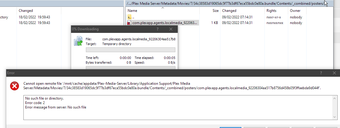

I just FTP'd in to see if these files truly don't exist. They show up just like they do through the Unraid web UI, but attempting to interact with them also presents the same error about them not existing...
As per my previous post's log, the video file does though.
Edited by Xenu
