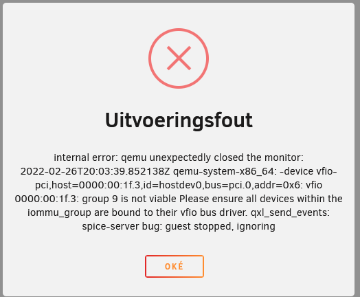

when i start my vm with a soundcard from the motherboard. I have a txt from the unraid system. look at the image with the name "unraid foutmelding bij opstarten vm"

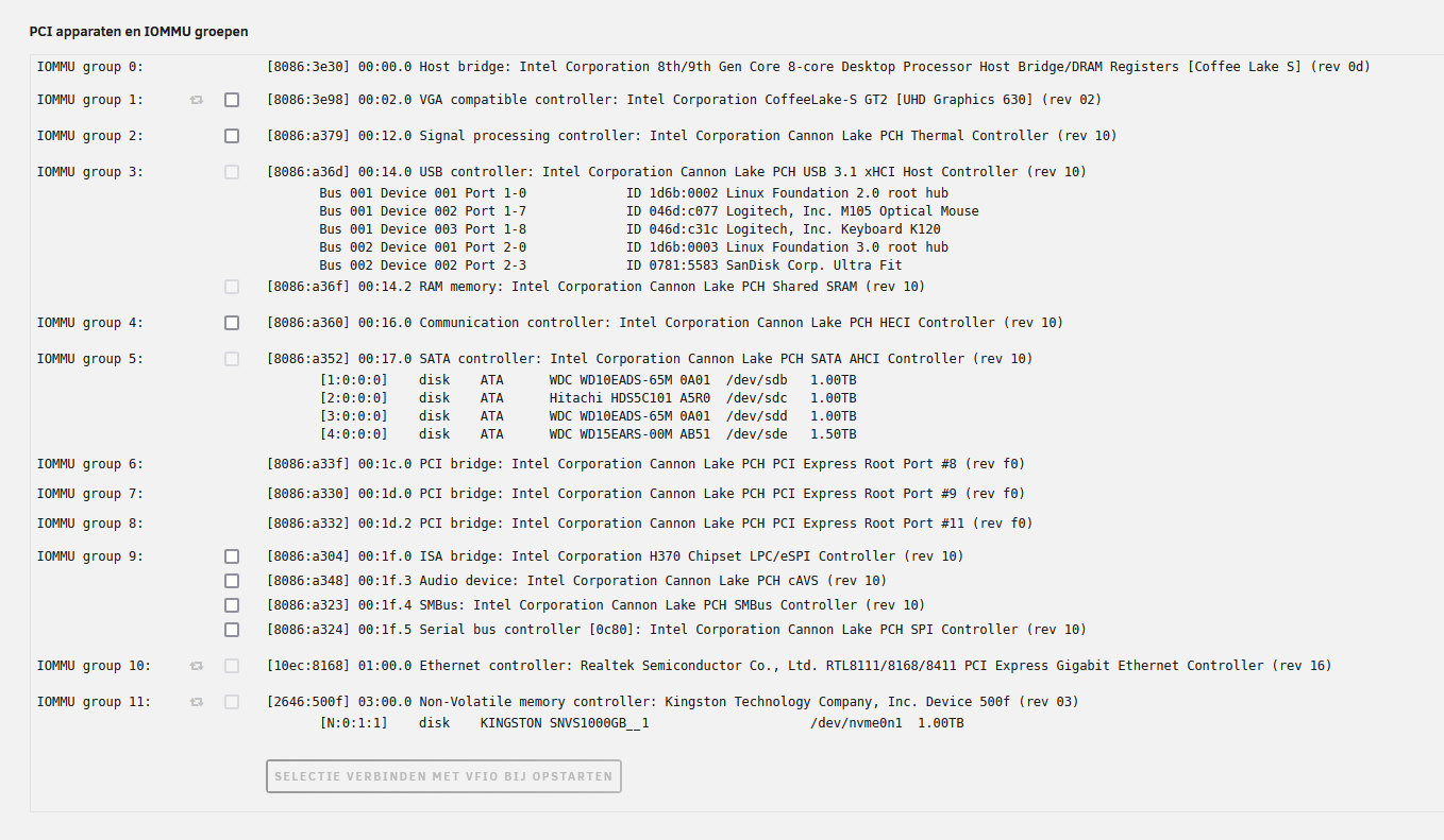

if i look to the system apparaten in the unraid server i find this. look at image with the name "unraid system apparaten"

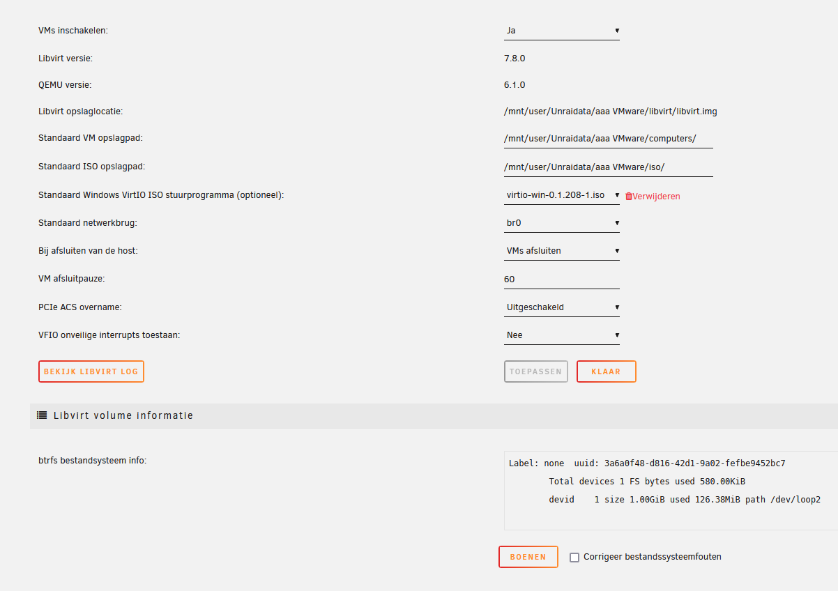

in the vm magager i found the setup: look athe the image with the name "unraid vm manager"
i know you can change settings in the system apparaten. but first you must change aci in overide at unraid vm manager.

The error is ultimately because you can't passthrough anything in an IOMMU group unless all devices are passed through (and you should also click the checkboxes to isolate them from the OS)  The ACS override options are to try and get the device you're attempting to passthrough into it's own group where it won't interfere with other system devices
At the end of the day, onboard sound / audio passthrough can be challenging because they don't "conform" to the same standards of add on card, and you may not be able to do it successfully.
I understand it won't work on my both computers. ok, thanks for the info.
