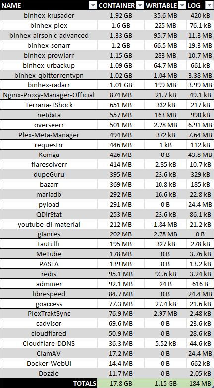

5 hours ago, VelcroBP said:
Is there an easy way for me to tell what applications are writing to the docker.img instead of an Array path?
Container Size button on the Dockers page might tell something.
Here are the results. Are they way out of line with expected?
