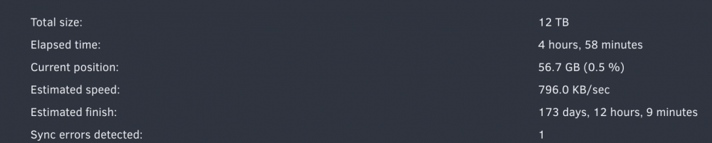

When I start my parity check the progress the array operation shows is super slow.
141466021_Schermafbeelding2022-02-21om13_12_35.thumb.png.b23cb45a6c8fb062f45ba201b9c0864b.png
I read a lot of topics about this subject but couldn't find my anwser how to fix it. I tried turning off all dockers etc.
any help?

ata9.00: ATA-10: ST10000DM0004-1ZC101,             ZA2DWBXE
This drive is continually resetting.  Most likely due to poor cabling connections.  Reseat (both ends) sata and power and don't disturb anything else

thanks for your quick response.  I see that I have a extra SATA connectors on to a PCIE controller. and that that specific drive is the only one connected to it. ill start to mess around with it to see if I can fix it.
This seem to work!
