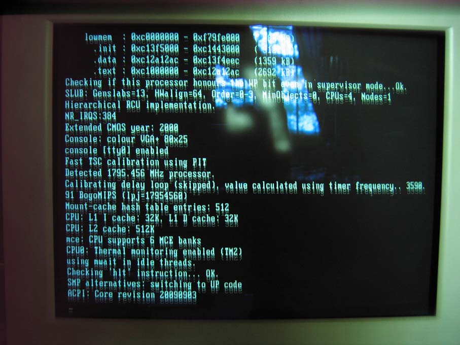

unRAID will not boot (ACPI: Core revision 20090903, last line)
Hello all,
I purchased the parts for an unraid server a while back and finally had the time to put them together but now I am running into a slight problem.  I set the BIOS to boot from USB, I turned off all the other HDD's for booting, I dumbed down the video memory so it uses as little as possible, and I get stuck on the screen in the attached picture.  It gets to the part where it asks me if i want to do a memtest or boot unraid and i select unraid and then get the attached screen.

I left it at that line and it stayed there for 10 min so I don't think its doing any processing, but maybe I'm wrong, should I need to leave it for longer than 10 min the first time it boots?
I see no syslog.txt on the usb device, I assume this means that it does not get very far into the boot sequence of unRAID.
It shouldn't take 10 minutes to boot,  maybe try resetting the bios to defaults?
tried resetting the bios to no avail, thank you for the advise though
i also tried setting the USB to fullspeed instead of highspeed to no avail
I just noticed while waiting on that screen that the network led is flashing, so maybe it is trying to connect but not sure.  it just sits on that screen with no data :(
updated to 4.7

What BIOS settings are you using for ACPI?
Did you ever try kernel parameters to resolve the problem?
I'd work toward the right BIOS options but acpi=off for your loader might be a quick workaround.
In case you haven't done that before, when the USB stick first boots you get to choose between unraid and memtest. Hit tab before the counter ends and you'll get to edit the "append initrd=bzroot" line for this one boot. Modify it to look like:
append initrd=bzroot acpi=off
Edit: Again, this will only take effect for this boot. To make it permanent you'll need to edit the original file at /boot/syslinux.cfg.
I was using YES/AUTO/LEVEL 2
I just turned it off so now its just NO
and it boots but does this mean that unRAID is no longer in control of the power for my hard drives?  Do I really want ACPI off?
