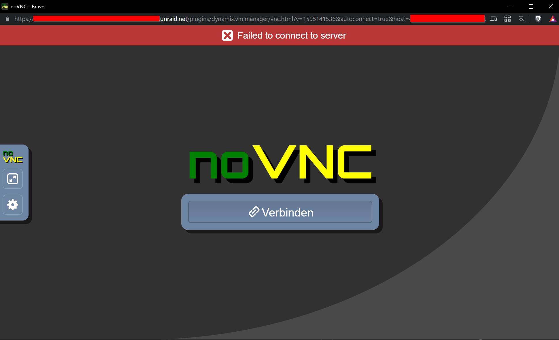

February 22, 20224 yr Hey there, I configured a VM in Unraid with VNC mode. If I connect with Guacamole I can reach the VM and use it like a charm. But when I try to connect with it through the Unraid Dashboard and the NoVNC Tool I get following Error in the sys.log: Quote Feb 22 16:11:32 TecMachine nginx: 2022/02/22 16:11:32 [error] 8875#8875: *118808 recv() failed (104: Connection reset by peer) while reading upstream, client: 192.168.178.35, server: xxxxxxxxxxxxxxxx.unraid.net, request: "GET //wsproxy/5700/ HTTP/1.1", upstream: "http://127.0.0.1:5700/", host: "xxxxxxxxxxxxxxxx.unraid.net" Can anybody help? Tec
March 22, 20224 yr Open a private window in your browser and test again, it could be some add-on in your browser interfering.
March 22, 20224 yr Author Hey hey, 4 hours ago, z0ki said: Same problem. Did you happen to fix this? Yes. I deleted all browser data. Cookies etc. Then it worked for me. But after a few connections the problem came again so I decided to choose another tool to connect over VNC.
August 1, 20224 yr Just happen to me as well. Worked with the application but not on the browser version.
October 4, 20223 yr I have the same Problem. OS Version 6.11 On 3/22/2022 at 8:52 AM, TecEgg said: Yes. I deleted all browser data. Cookies etc. Then it worked for me. But after a few connections the problem came again so I decided to choose another tool to connect over VNC. I dont like to delete all cookies. Instead, i use Chrome, if the noVNC Tab open, i go to the upper left Corner ("not safe" in Adress Bar (http/s)) an left Klick on it. There i can delete the specified cookies. Thats help me.
