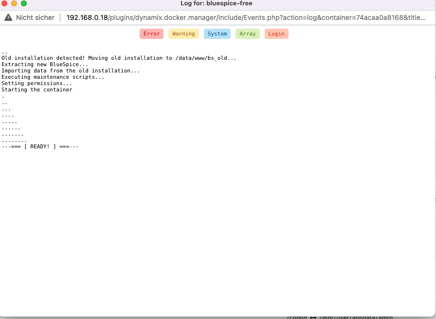

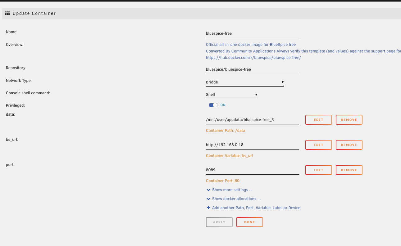

I installed the BlueSpice-free version from dockerhub from within the CA in unraid and set up the environment variables bs_url=http://192.168.0.18 (my server) and port 80:8089 but when I try to open http://192.168.0.18:8089 only the unraid webui opens. I also tried bs_url=192.168.0.18 and bs_url=http://192.168.0.18:8089 with the same result. I'm at my wits end. Is it not supposed to work on a server but only on localhost like described on their Dockerhub?
I'm pretty sure it's something very easy I'm missing. I'm thankful for any pointers.

I managed to solve it.
The URL should not be http://server:port but rather http://server:port/wiki
