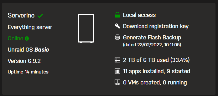

Your screenshot shows the My Servers dashboard when you are on the same network as the server, it has the "Local access" url:
  https://hash.unraid.net:3443
When you are outside your network it will show a "Remote access" url, which is different.
  https://www.hash.unraid.net:wanport
Are you testing with the correct urls?

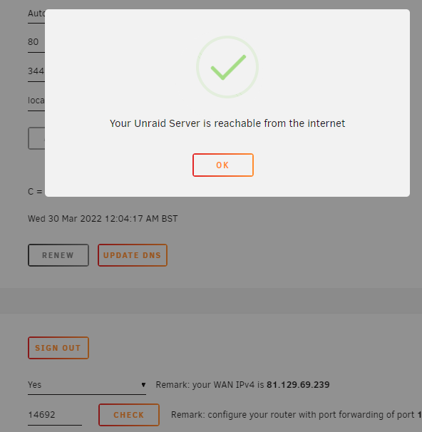

The "Your Unraid server is reachable from the Internet!" message means that one of our systems was able to access this file on your server:
  https://www.hash.unraid.net:wanport/robots.txt
so your port forward is setup correctly and your phone or another system outside of your network should be able to access it as well.

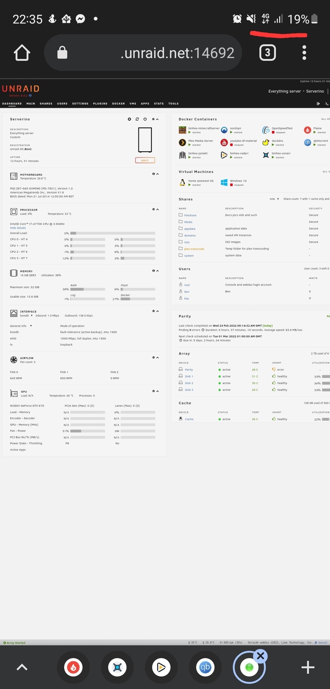

I got it in the end, after a few hours it started showing that remote access was there when I was outside my network.

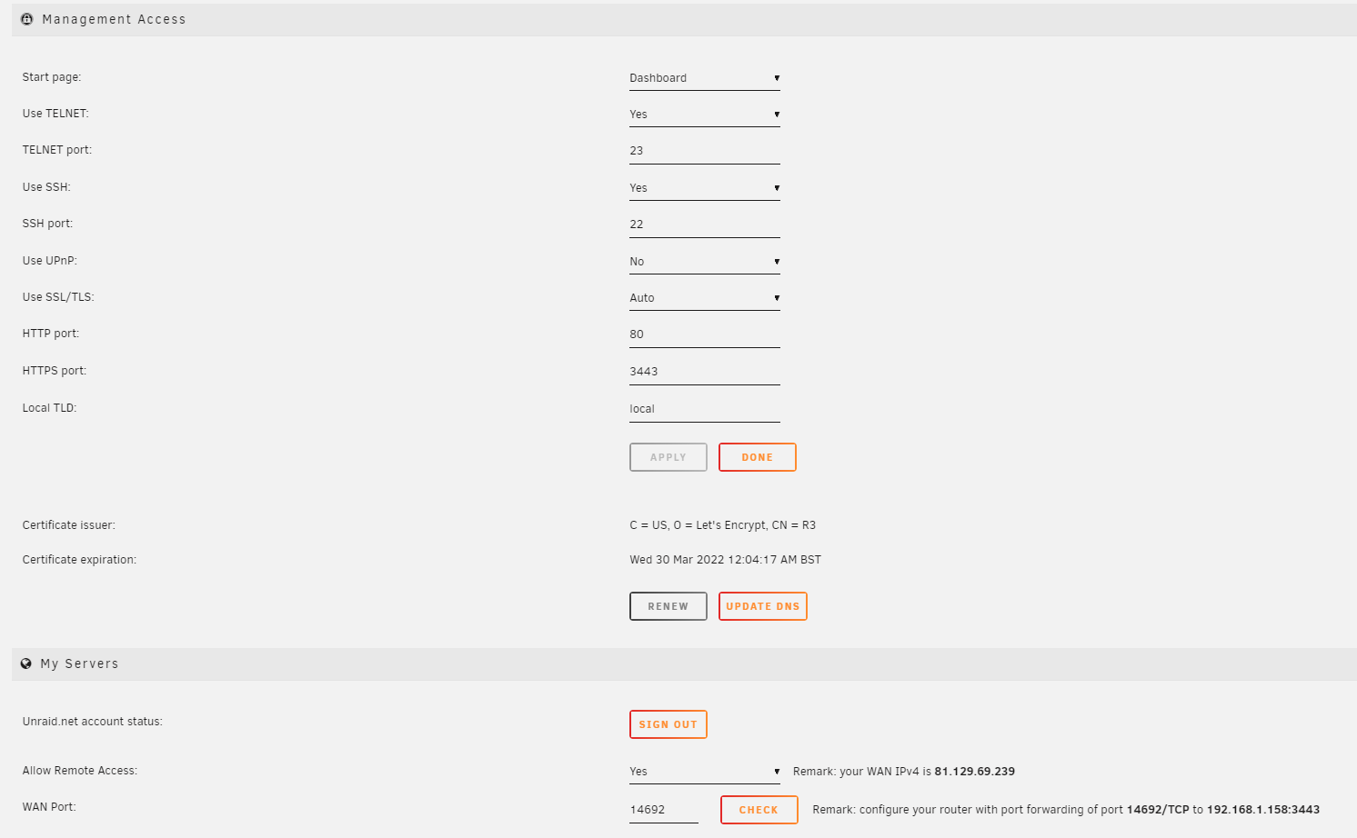

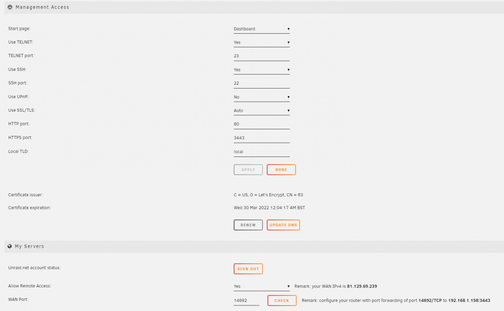

Dude, always blank out your Wan ip adres[emoji1751]
Came along the thread, and saw it in the pictures
