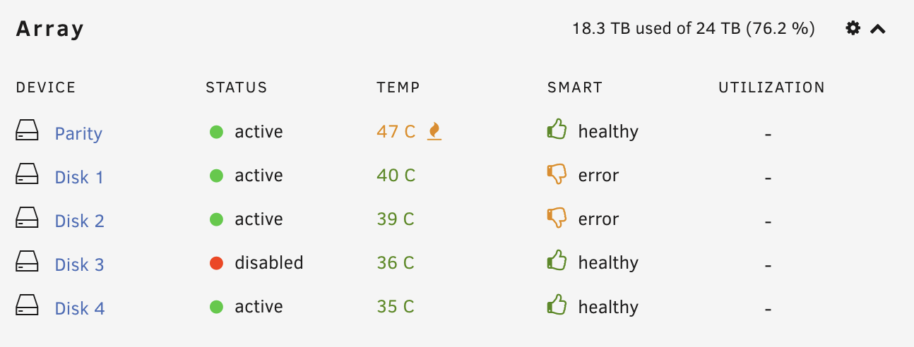

Hello! I seem to be in a bit of a pickle. Two of the data disks in my 4-disk array are reporting SMART errors. One seems to pass xfs_repair with no problems, while with the other one xfs_repair fails on an i/o error.

Meanwhile, a third disk is marked "disabled" although it reports no SMART errors, and will not seem to come back into the array even after stopping and restarting the array. I've run xfs_repair on it and it doesn't seem to have any errors.

From looking at the xfs_repair output and smart tests, it seems clear that disk2 is a goner and will need to be replaced. I've actually got two new disks that I can swap in right now, but I'd like some advice before I do it.
Right now my shares are all marked as "unprotected" which makes me worry that I'll lose data if I just clear a disk.
So my questions are:
- What should I do about disk #2, which has the i/o failures shown above?
- Disk #1 shows a little SMART thumbs-down icon in the dashboard, but the last time I ran self-tests it was fine. Does hitting "acknowledge" clear the thumb-down icon? Should I consider this disk compromised as well?
- What can I do to get disk #3, which shows status "disabled", back into the array?
- What can I do do try to minimize data loss before I pull disk #2 (and maybe the others) out of the array?

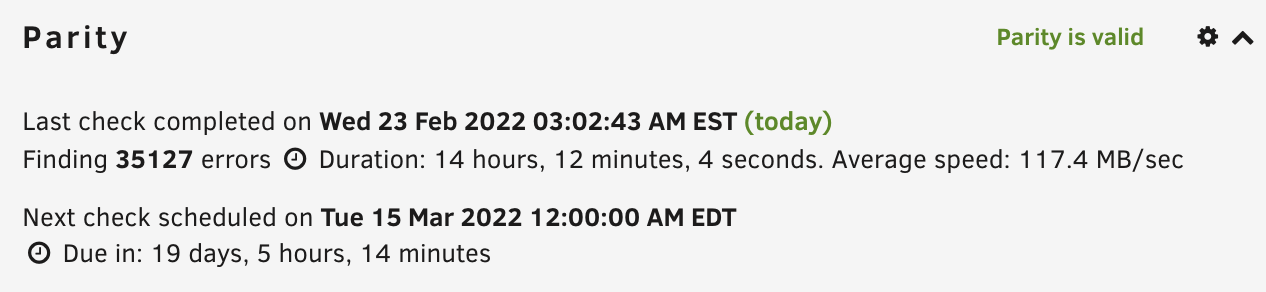

Oh, one other thing: this was probably a mistake, but I ran a parity check after I noticed things were failing. I got a lot of errors:
Does this mean I'm screwed for data recovery? Like, if the parity disk couldn't read a bit from the failing disk, it wouldn't be able to compute the parity for that bit across all four disks, would it?
There appear to be 3 failing disks with single parity, so some some data loss is expected, disk2 is failing for sure, disk1 might also be, run an extended SMART test on disks 1 and 3 and post new diags once they are done.
