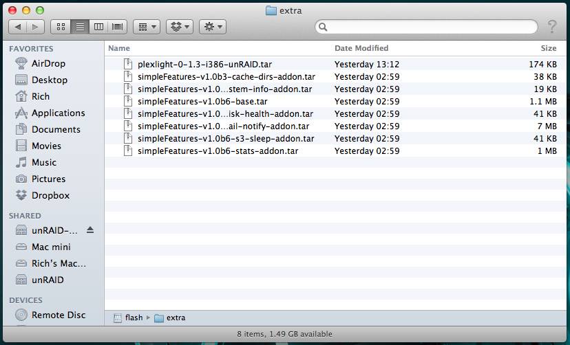

Please post screenshot of your flash extra folder. It should just work, your go file is fine! Extra folder is an automated way of running and installing packages on boot.
Cheers!
Cheers!
Here's the requested pic, thanks  :)
Ah yep - looks like the original packages have been decompressed (might be automatic depending on your browser settings). They should be untouched from google code, and should have .tgz as the extension.
Cheers
Cheers
Awesome, simplest solution ever, but i would have never have known unless told.
Thanks, a lot,
Rich

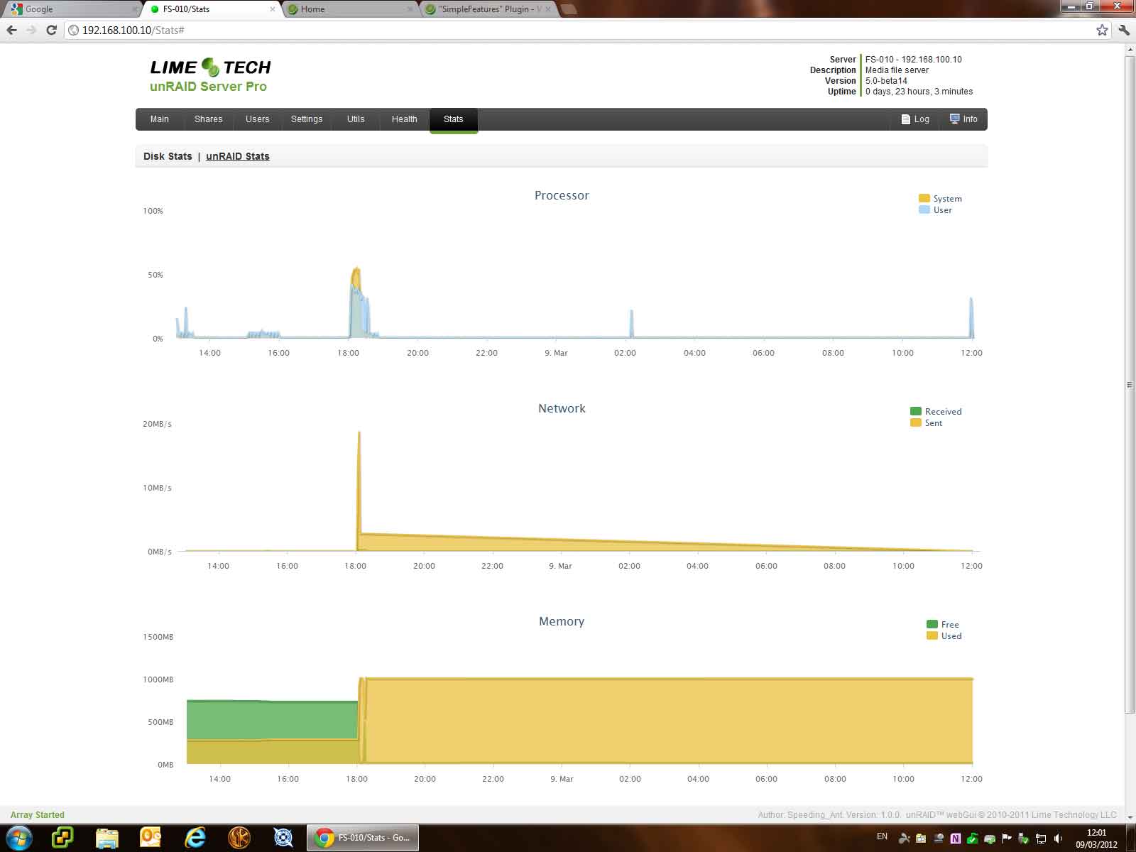

Hi, Speeding_Ant
I would like to thank you one more time for this marvelous piece of software.
There is a minor bug I have noticed with the latest version. Have a look on attached screen print. Check out network graph. You will see that after a file transfer (spike in processor usage) the network usage graph didn't go down to zero activity at a due time, but rather was spread linearly from the time of transfer termination till the current time. This happens both in IE9 and Chrome.
Regards,
Eugene
