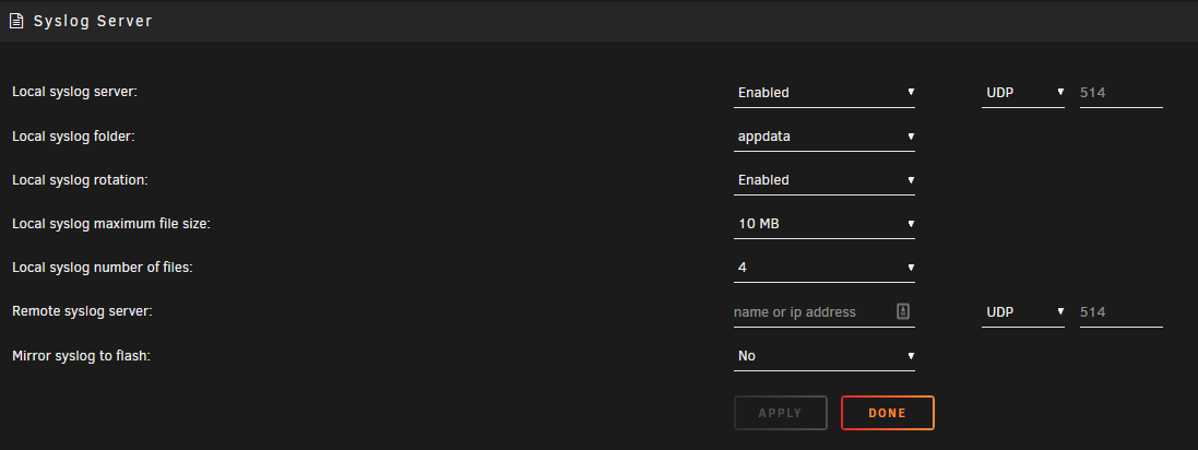

So, I got my server up.  And I enabled Syslog Server.  Set it to dump a syslog into Appdata, but nothing is in Appdata.  Is there a setting I've done wrong?
According to your screen shot you have so far only set up the server to receive syslog entries from other machines.
You have two options:
  • set the IP address of your server into the remote syslog server field so your server logs to itself.
  • set the option to mirror the syslog to flash

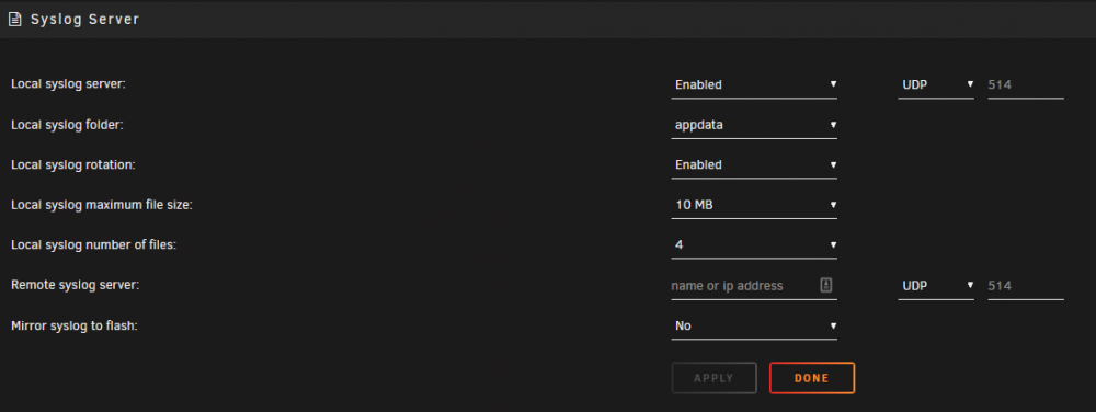

I Set it to Localhost.  And it appears to be working.  The server was all good yesterday, went to sleep, woke up to the OS hanging on boot.  Must have powered down again last night.  Ugh.  Reset the system again, and got it to boot.  It appears that the OS crashed around 3AM, and hung in the boot process around 8, and then when I reset the system.

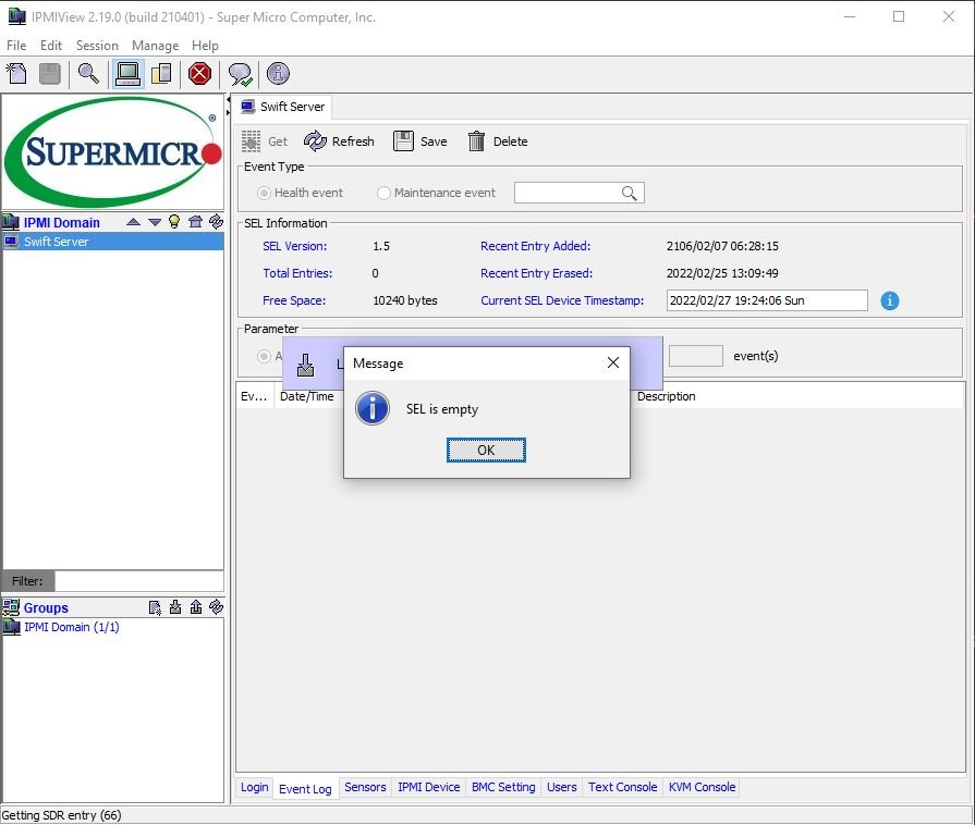

Also the SuperO IPMI event log is empty!

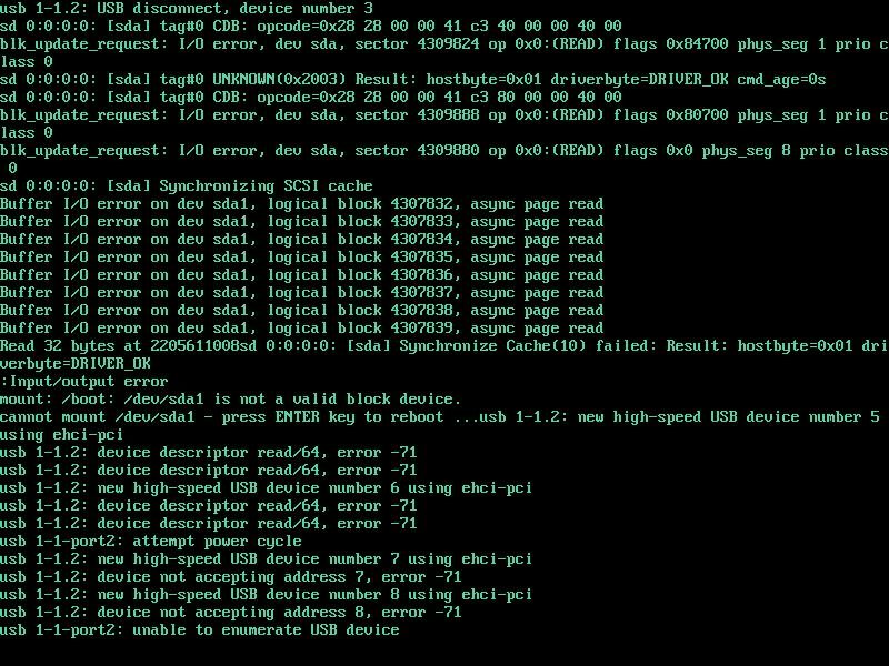

I saw it was throwing USB errors, and there are two front case USB ports.  I unplugged them, reset the server, and it came up as per usual.  I got the IPMI recording going, so we shall see if it crashes again... Or if something went bad with the front case USB ports.  I don't want to get my hopes up... so we shall see!
I'm going to leave the server running for another 2 or 3 days to check for stability.  Then do a Parity Check.  Then boot my dockers and VM's.
Also, the sda1 on the screen grab is the OS flash drive?  Straaaange.
