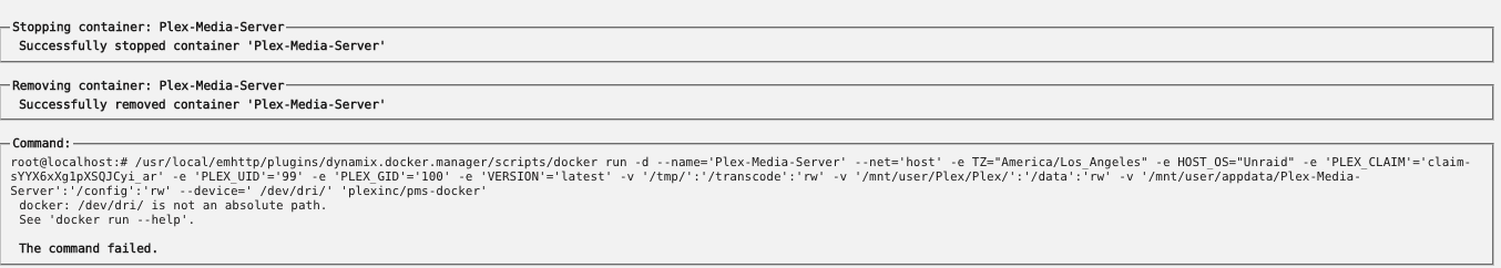

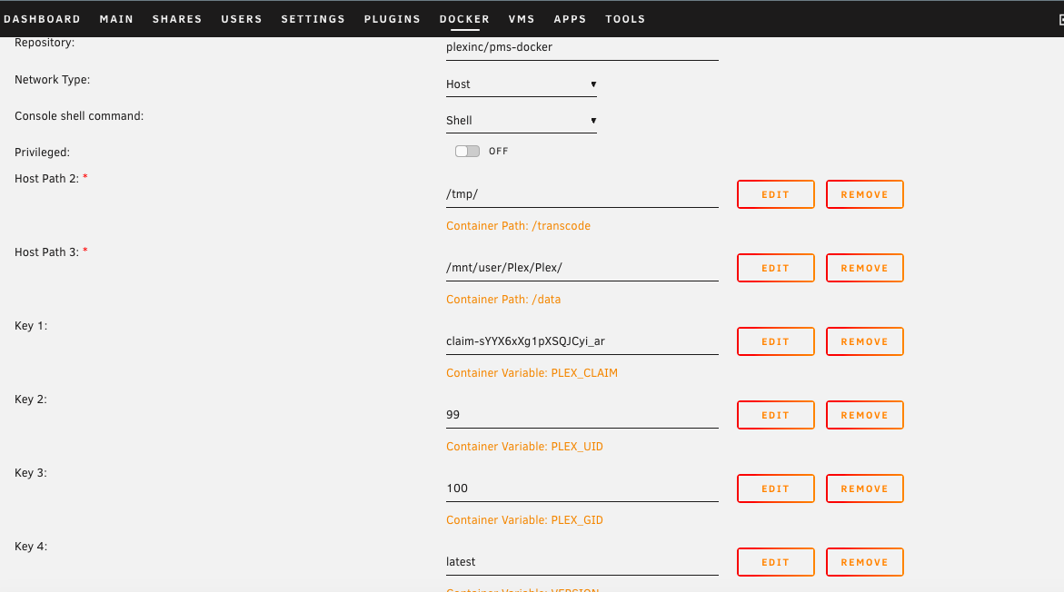

when I add the bit in extra parameters, Something like --device=/dev/dri:/dev/dri in Extra Parameters or /dev/dri as a container device
and then apply, it crashes and says that docker /dev/dri is not an absolute path.
Then I have to reinstall the docker and remove the additional path just to be able to run the container at all.
You have verified that you have a /dev/dri folder on the server and that it has the appropriate contents?
If this does not exist as seen above, any Plex docker will fail to start since you are passing it a device it cannot find.

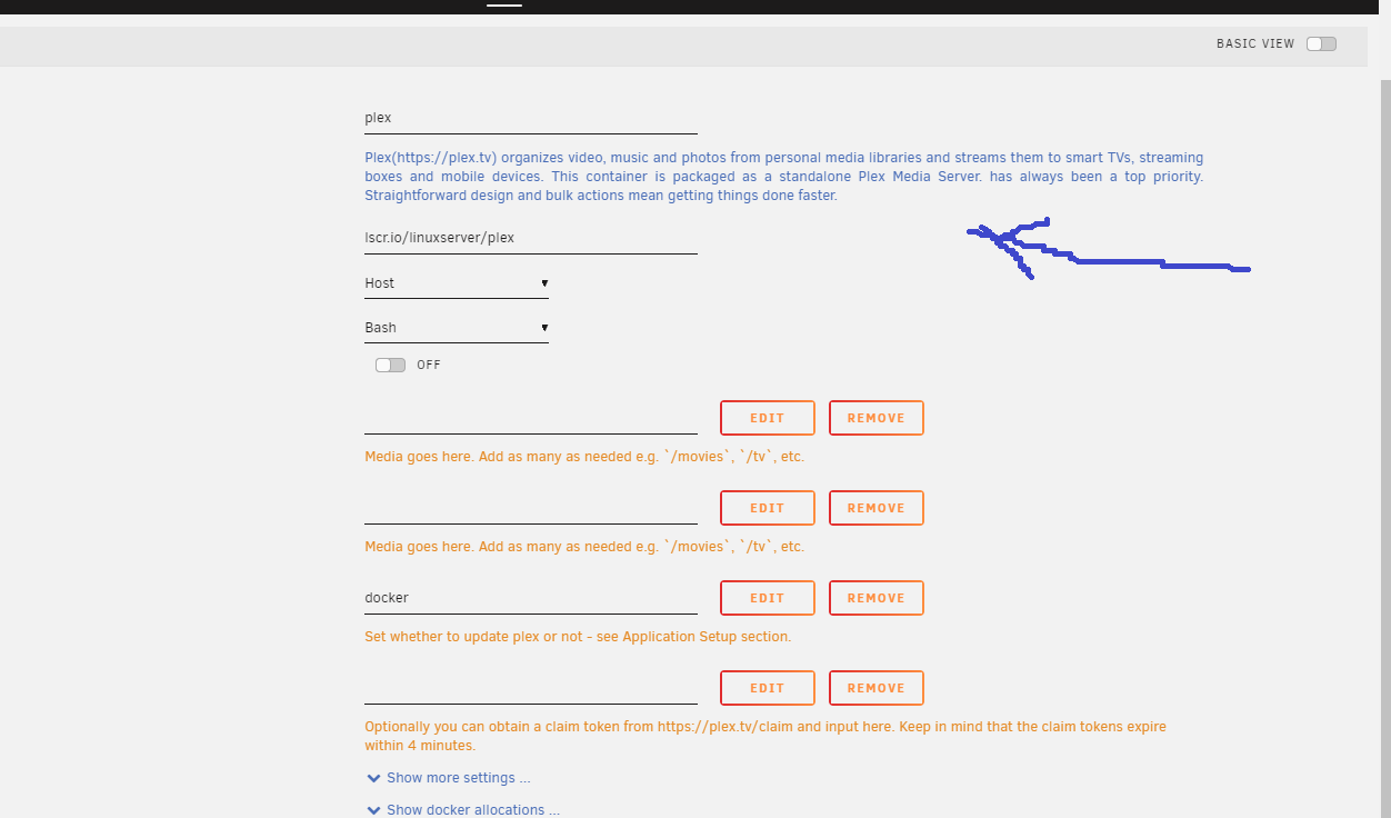

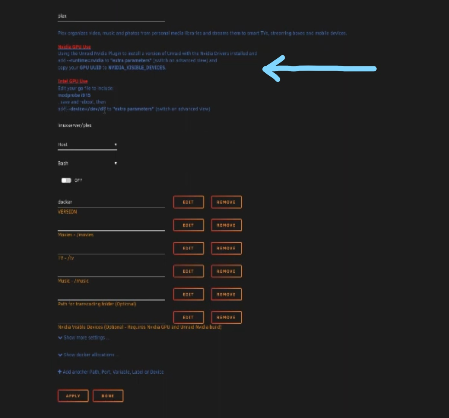

I have been looking at using the linuxserver.io instead but on the videos I've seen, when they're setting it up there is a bit at the beginning to click on for intel quicksync1533634006_intelbit.thumb.png.b11a8c46a959e2be1218f8554323be89.png but when I try using the same container it isn't there - what am i doing wrong!143914510_nointelbit.thumb.png.6681de305c517ce836685101ea04ed4c.png
Thanks again for your help - I really do appreciate it.

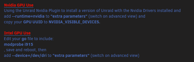

This is just instructional text telling you how to set up the container to use with and Nvidia GPU (with the plugin) or the iGPU in an Intel CPU.
LSIO has changed the description they used to include.  If you click on the ReadMe First either within CA (Support) or after it's installed by clicking on the icon, the same directions will show up
