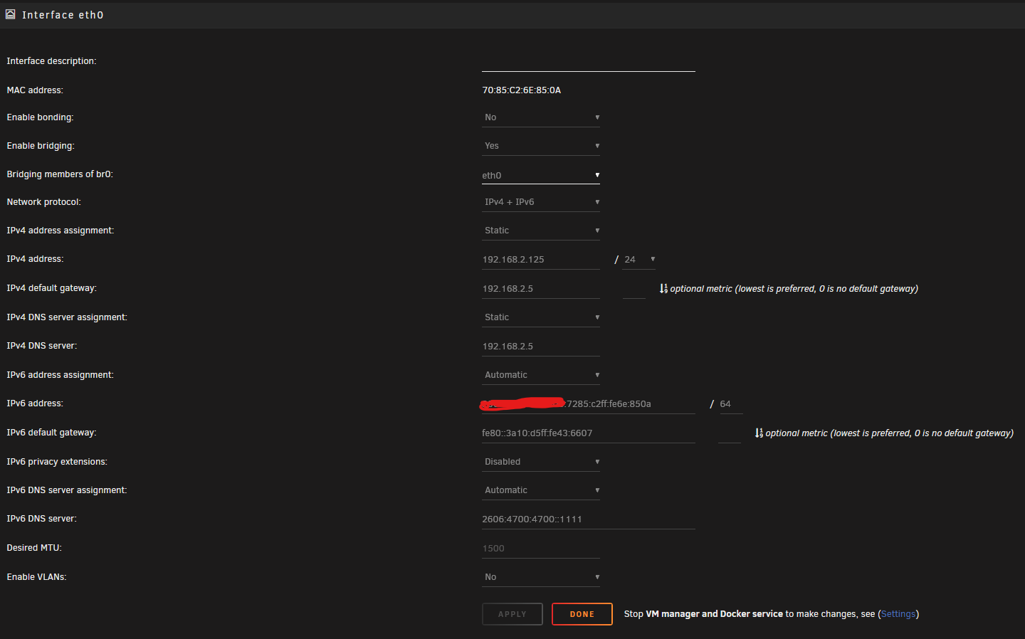

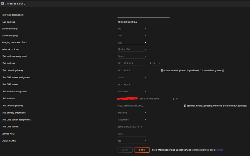

I tried to set up pi-hole in a docker for which the interface  custom:br0 is necessary. But it is not available for me. I've searched the forum and googled for it, so I know I'm not the first one with this problem. But the solutions that worked for others for some reason don't work for me. From all I can tell I've set everything up correctly - although presumably I have not, since it doesn't work. I also tried this command I found on the forum to no avail
rm /var/lib/docker/network/files/local-kv.db
/etc/rc.d/rc.docker restart

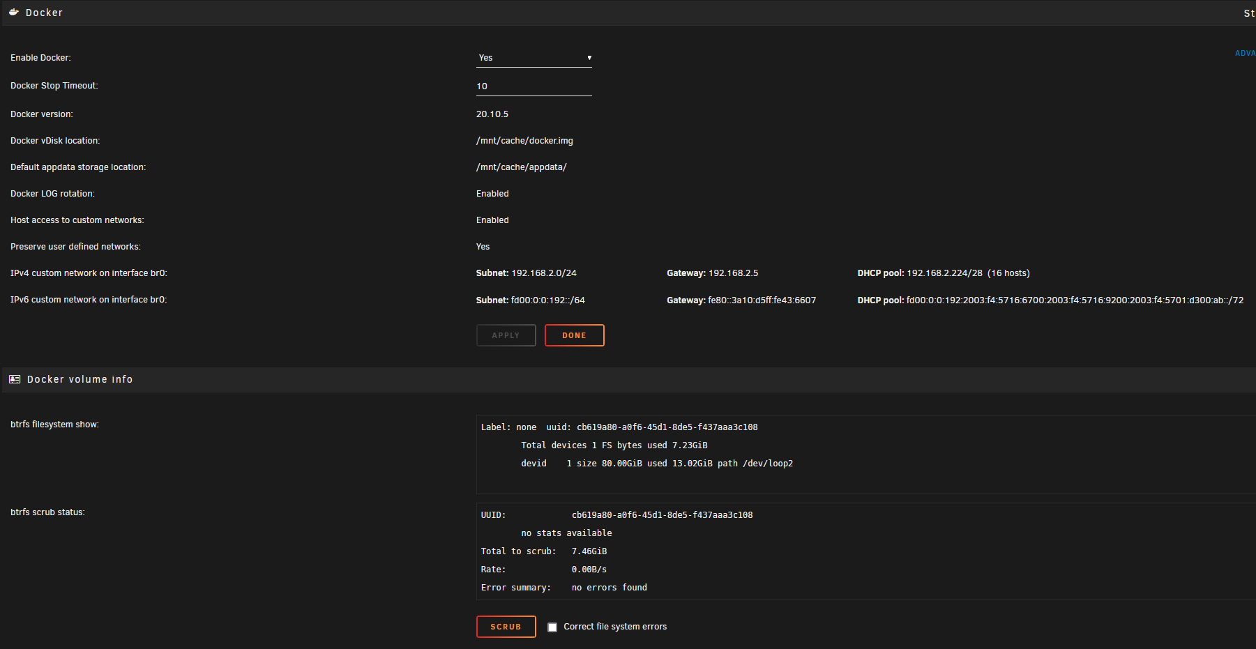

My config are as follows:
I don't have any other network cards in my server, so interference on that side can't be it. Can anyone tell me what is wrong in this config?
Please remove the IPv6 DHCP pool, this is conflicting and not needed. Docker IPv6 gets the IP assignment using SLAAC.
Thank you, deactivated both DHCP pools and now it's there :)
