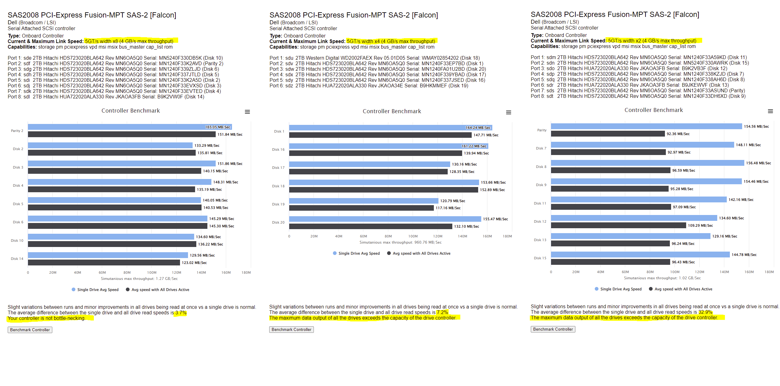

HBA PCIe Benchmarks:
HBA1 = 5/GT width x8 (4GB/s Max)
HBA2 = 5/GT width x4 (4GB/s Max) <- Bottlenecked
HBA3 = 5/GT width x2 (4GB/s Max) <- Bottlenecked

1. Complications of running 3 x LBA's on this board. As you can see in the attached pic, 2 controllers are bottlenecked but im more concerned by the different bandwidth between identical controllers being an issue.

I've included my diagnostics below and a screen shot of my HBA's benchmarked through the handy speeddisk container. If anyone can sanity check the logs i'd be greatly appreciative.
