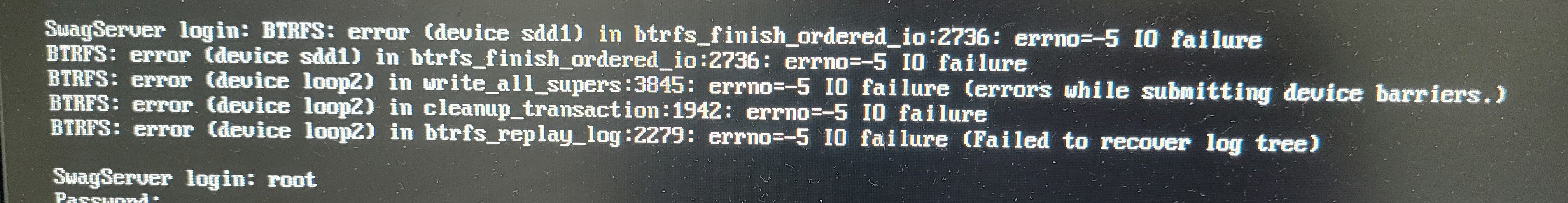

I've been trying to solve this on my own. I tried to see which file is at 11057991 and I've found that it's the docker.img file. I have tried to delete this file from the GUI, by following the guide, but I'm still getting the error and the file is not deleting.
I then tried to delete it manually from command line but I get another error that says the cache is a read-only filesystem.
I have also tried to restart the server and when I did I saw this error (see screenshot.)
My sever has been down for over a week so any help would be greatly appreciated. I'm attaching diagnostics as well.
