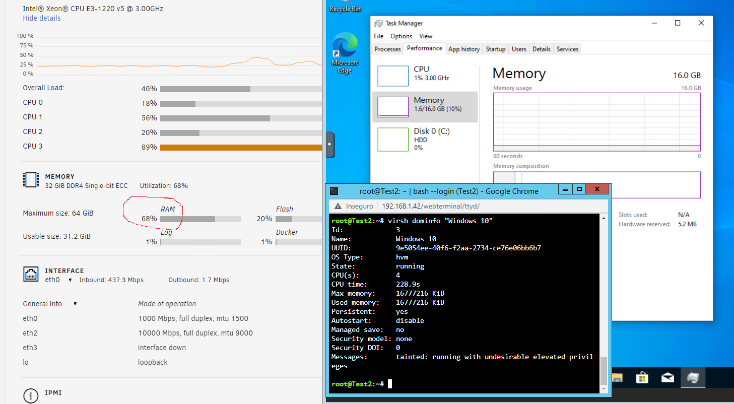

I've been doing some testing and ballooning is working with Unraid and Windows, this is a VM set to 4GB minimum and 16GB max, before installing the balloon driver and service:
Same VM after installing the ballon driver and service:
Note that the used RAM reported by Windows is not correct, this is normal, see this post:
https://github.com/virtio-win/kvm-guest-drivers-windows/issues/568
Couple of notes:
- Install both the balloon driver and service, though the driver seems enough for this to work the service reportedly helps with performance, you can install everything by running virtio-win-gt-x64.exe from the virtio ISO root.
- memory ballooning won't work if any PCI(e) device is being passed-through to that VM, this is because all the RAM must be allocated for possible DMA use.

"You don't mention which hypervisor you're using, so I'm going to guess KVM, but my answer applies to Xen too. When you set currentMemory=16384 and maxMemory=32768, you are telling KVM to boot with 32 GB of RAM and use balloon driver to reduce that to 16 GB.Once the balloon driver has reduced the RAM to 16 GB, it will never be increased again unless you explicitly tell KVM to increase. It won't adjust itself without you telling it to."
And at the very top of the link I posted above:
"EDIT: For future reference, virtio memory ballooning is not dynamic by default. Meaning, if you want the guest to request more memory from the hypervisor based on something like memory pressure, that would be up to you to set up (a script talking to a virto channel should work)."
So I believe, and if I'm wrong someone please correct me, that it will never automatically add or remove allocated RAM to a VM, you can do it manually or with some sort of script, for example, say I want my Windows VM to usually use 2GB of RAM, but sometimes I need to run some app that requires 16GB, I set the VM to 2GB/16GB, install the balloon driver and service and after boot the VM will only use 2GB, the rest will be released to the host, when I need the extra RAM type in the Unraid console:
virsh setmem "Windows 10" --size 16777216
Of course the host needs to have enough free RAM at that time, when the VM no longer requires the extra RAM type:
virsh setmem "Windows 10" --size 2097152
And the VM goes back to using 2GB of RAM, releasing the rest to the host, basically this as implemented allows you to add or remove allocated RAM to a VM on the fly and with the VM running, since KVM does not support dynamically changing this I guess it would be possible for Unraid to change it based on the RAM pressure of the host/VM, but no idea if this is even possible to implement for all guest OSes, I guess users can make a feature request and if there is enough interest and it's feasible LT might do it in the future.
