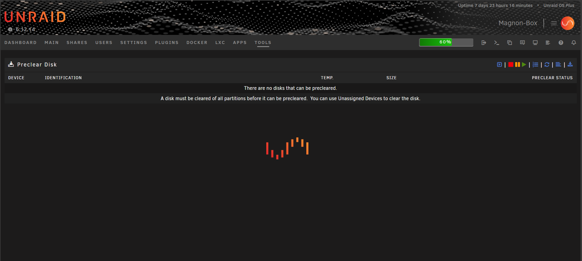

I believe something is not working correctly with this plugin, if you load the plugin from the Tools menu you just get the moving/loading unRAID logo and can't interact with anything.  It does still work from the Main tab under Unassigned devices.  I tried reinstalling the plugin as well same issue.  Running 7.0.0-rc.2.  Attached Diagnostics if need.

That issue,
also exists on 6.12.14
BUT, in 6.12.14 you can actually hover over the buttons and get the button info and press the buttons on the top right, which doesnt work on 7-RC2. All you have is a spinning curser. Locks up everything basically because the Dashboard and Main links stop working too
Edit: The issue starts appearing with version 2024.12.05 for 6.12.14 @dlandon
Edited by Mainfrezzer
specified the version
It's an issue with Chrome.  Probably with a recent update.  Fixed in today's release.
