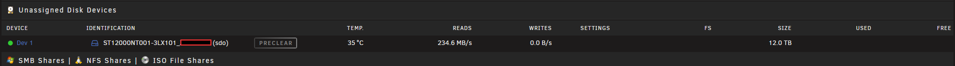

Did my best to make sure I'm following etiquette with this post... I tried preclearing two new 12TB HDD at the same time and one of them came back with this? it looks like there's still full I/O happening based on the activity listed in the Main tab/unassigned devices. The plugin page shows "Preclear Finished Successfully!" but the other disk entered the zero-ing stage while this one did not. i'm unable to do anything with the disk as it looks like it's still being cleared and the "Preclear" button is grayed out. Tried chatgpt, but wasn't confident in the responses and wasn't able to find any references to this anywhere else. I'm assuming this isn't a disk issue? Do I need to abort this somehow, or will the reading of the disk stop at some point? Any help is appreciated!
Oct 21 12:27:48 preclear_disk_ZRT2HR1V_39819: Preclear Disk Version: 1.0.31 Oct 21 12:27:48 preclear_disk_ZRT2HR1V_39819: Disk size: 12000138625024 Oct 21 12:27:48 preclear_disk_ZRT2HR1V_39819: Disk blocks: 2929721344 Oct 21 12:27:48 preclear_disk_ZRT2HR1V_39819: Blocks (512 bytes): 23437770752 Oct 21 12:27:48 preclear_disk_ZRT2HR1V_39819: Block size: 4096 Oct 21 12:27:48 preclear_disk_ZRT2HR1V_39819: Start sector: 0 Oct 21 12:27:50 preclear_disk_ZRT2HR1V_39819: Pre-read: pre-read verification started 1 of 5 retries... Oct 21 15:33:40 preclear_disk_ZRT2HR1V_39819: Pre-Read: progress - 25% read @ 262 MB/s Oct 21 18:55:28 preclear_disk_ZRT2HR1V_39819: Pre-Read: progress - 50% read @ 232 MB/s Oct 21 18:57:01 preclear_disk_ZRT2HR1V_39819:  Oct 21 18:57:01 preclear_disk_ZRT2HR1V_39819: malloc: jobs.c:1475: assertion botched Oct 21 18:57:01 preclear_disk_ZRT2HR1V_39819: free: called with unallocated block argument Oct 21 18:57:01 preclear_disk_ZRT2HR1V_39819: Aborting.../usr/local/emhttp/plugins/unassigned.devices.preclear/scripts/preclear_disk.sh: line 595:  100 /   8045980 : syntax error: operand expected (error token is " 100 /   8045980 ") Oct 21 18:57:01 preclear_disk_ZRT2HR1V_39819: Preclear: total elapsed time: 6:29:13
Edited by ianraff

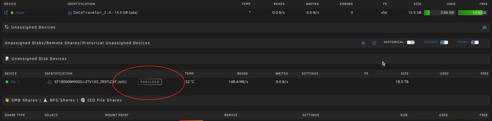

There also doesn't seem to be a way to follow preclear progress.
It's been a while since I last used preclear but isn't this supposed to link to a progress window?
Preclear should be running but I can't open the window.
You have to go to tools->preclear to see status, was removed from here a while ago sadly...
