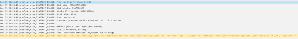

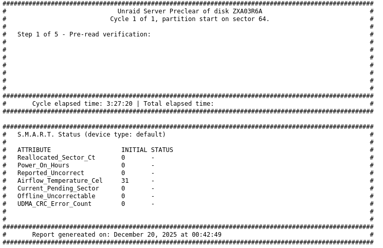

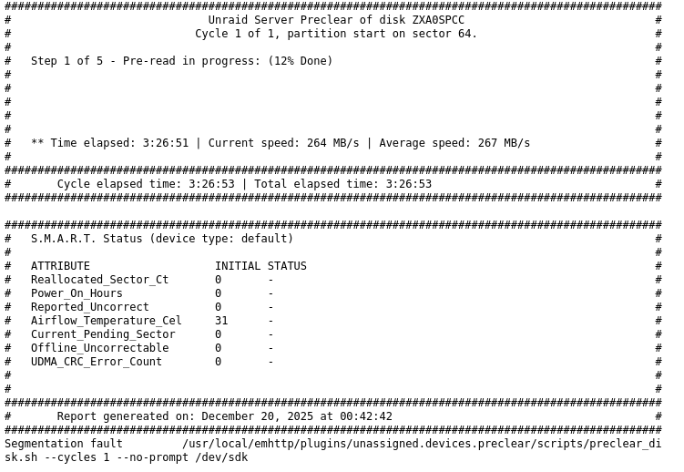

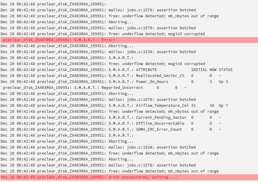

Hi! I recently got two refurbished/recertified 26TB Seagate drives and started a default preclear run on them. One had an error and the other looks like it's still running in the GUI but seems to have also stopped, since the report hasn't updated in the last hour.
Unraid Version 7.2.1
Disk 1 - error
Dec 20 00:42:48 preclear_disk_ZXA03R6A_109951:  Dec 20 00:42:48 preclear_disk_ZXA03R6A_109951: malloc: jobs.c:1578: assertion botched Dec 20 00:42:48 preclear_disk_ZXA03R6A_109951: free: underflow detected; mh_nbytes out of range Dec 20 00:42:48 preclear_disk_ZXA03R6A_109951: Aborting... Dec 20 00:42:48 preclear_disk_ZXA03R6A_109951: malloc: jobs.c:1579: assertion botched Dec 20 00:42:48 preclear_disk_ZXA03R6A_109951: free: underflow detected; magic8 corrupted  preclear_disk_ZXA03R6A_109951: S.M.A.R.T.: Error: Dec 20 00:42:48 preclear_disk_ZXA03R6A_109951: Aborting... Dec 20 00:42:48 preclear_disk_ZXA03R6A_109951: malloc: jobs.c:1534: assertion botched Dec 20 00:42:48 preclear_disk_ZXA03R6A_109951: S.M.A.R.T.: Dec 20 00:42:48 preclear_disk_ZXA03R6A_109951: free: underflow detected; magic8 corrupted Dec 20 00:42:48 preclear_disk_ZXA03R6A_109951: S.M.A.R.T.: ATTRIBUTE               INITIAL NOW STATUS Dec 20 00:42:48 preclear_disk_ZXA03R6A_109951: S.M.A.R.T.: Reallocated_Sector_Ct   0       0   - Dec 20 00:42:48 preclear_disk_ZXA03R6A_109951: S.M.A.R.T.: Power_On_Hours          0       3   Up 3  preclear_disk_ZXA03R6A_109951: S.M.A.R.T.: Reported_Uncorrect      0       0   - Dec 20 00:42:48 preclear_disk_ZXA03R6A_109951: Aborting... Dec 20 00:42:48 preclear_disk_ZXA03R6A_109951: malloc: jobs.c:1578: assertion botched Dec 20 00:42:48 preclear_disk_ZXA03R6A_109951: S.M.A.R.T.: Airflow_Temperature_Cel 31      38  Up 7 Dec 20 00:42:48 preclear_disk_ZXA03R6A_109951: free: underflow detected; mh_nbytes out of range Dec 20 00:42:48 preclear_disk_ZXA03R6A_109951: S.M.A.R.T.: Current_Pending_Sector  0       0   - Dec 20 00:42:48 preclear_disk_ZXA03R6A_109951: S.M.A.R.T.: Offline_Uncorrectable   0       0   - Dec 20 00:42:48 preclear_disk_ZXA03R6A_109951: S.M.A.R.T.: UDMA_CRC_Error_Count    0       0   - Dec 20 00:42:48 preclear_disk_ZXA03R6A_109951: S.M.A.R.T.:  Dec 20 00:42:48 preclear_disk_ZXA03R6A_109951: Aborting... Dec 20 00:42:48 preclear_disk_ZXA03R6A_109951: malloc: jobs.c:1534: assertion botched Dec 20 00:42:48 preclear_disk_ZXA03R6A_109951: free: underflow detected; mh_nbytes out of range Dec 20 00:42:48 preclear_disk_ZXA03R6A_109951: Aborting... Dec 20 00:42:48 preclear_disk_ZXA03R6A_109951: malloc: jobs.c:1578: assertion botched Dec 20 00:42:48 preclear_disk_ZXA03R6A_109951: free: underflow detected; mh_nbytes out of range Dec 20 00:42:49 preclear_disk_ZXA03R6A_109951: error encountered, exiting ...
Disk 2 - warning
Dec 19 21:15:47 preclear_disk_ZXA0SPCC_116051: Preclear Disk Version: 1.0.31 Dec 19 21:15:48 preclear_disk_ZXA0SPCC_116051: Disk size: 26000658268160 Dec 19 21:15:48 preclear_disk_ZXA0SPCC_116051: Disk blocks: 6347816960 Dec 19 21:15:48 preclear_disk_ZXA0SPCC_116051: Blocks (512 bytes): 50782535680 Dec 19 21:15:48 preclear_disk_ZXA0SPCC_116051: Block size: 4096 Dec 19 21:15:48 preclear_disk_ZXA0SPCC_116051: Start sector: 0 Dec 19 21:15:50 preclear_disk_ZXA0SPCC_116051: Pre-read: pre-read verification started 1 of 5 retries... Dec 20 00:42:42 preclear_disk_ZXA0SPCC_116051:  Dec 20 00:42:42 preclear_disk_ZXA0SPCC_116051: malloc: jobs.c:1534: assertion botched Dec 20 00:42:42 preclear_disk_ZXA0SPCC_116051: SIGEXIT received, exiting ... Dec 20 00:42:42 preclear_disk_ZXA0SPCC_116051: free: underflow detected; mh_nbytes out of range Dec 20 00:42:42 preclear_disk_ZXA0SPCC_116051: Aborting.../usr/local/emhttp/plugins/unassigned.devices.preclear/scripts/preclear_disk.sh: line 595:  100 /  32835844 : arithmetic syntax error: operand expected (error token is " 100 /  32835844 ")
Any idea what the problem might be?

This looks like a memory (RAM) issue, I'd run a memory test.
The malloc assertion botched message is either there was not enough memory to fulfill the request or there is a bug in preclear. Unfortunately, the current preclear script uses a buffer file in the tmpfs ram file system to read and write disk data. Most of the time this shows up as not enough memory that preclear detects and it stops running when preclear sees there is not enough memory.
The size of the buffer depends on the disk size and with a bigger disk that can be extremely large. The preclear script needs to be rewritten to do reads and writes without using a memory buffer.
I removed the read after write check some time ago that verified that zeroes were actually written to the disk during the write cycle as it was time consuming (the preclear time was about 2X a write cycle alone). The cycle was write zeroes and then read the disk and verify zeroes were written. The read has to insure the actual disk was read, and not the disk buffer. This takes time - at least one revolution of the platter, maybe more for the read after write.
I did not get back to to remove the buffer file use as it is a major rewrite. With newer model disks, the cycle should be:
  • Optionally do a pre-read, but don't verify zeroes were actually written.
  • Write zeroes to all sectors of disk without any errors appearing. Don't use a memory buffer.
  • Check SMART report for disk problems while writing to detect a failing disk before a complete write cycle is finished saving a lot of time.
  • Write a preclear signature if disk does not have issues.
  • Optionally do a post-read, but don't verify zeroes were actually written.
Modern disks will report issues with reads and writes and show in the SMART report things like pending and uncorrectable sectors that indicates problems.
The disk that is hanging is probably a bug in preclear.
Thanks both of you. I think it was the RAM. I ran a memtest which failed so I checked every stick and it seems one of them is faulty. Will use three sticks for the time being, because of the insane prices currently.
