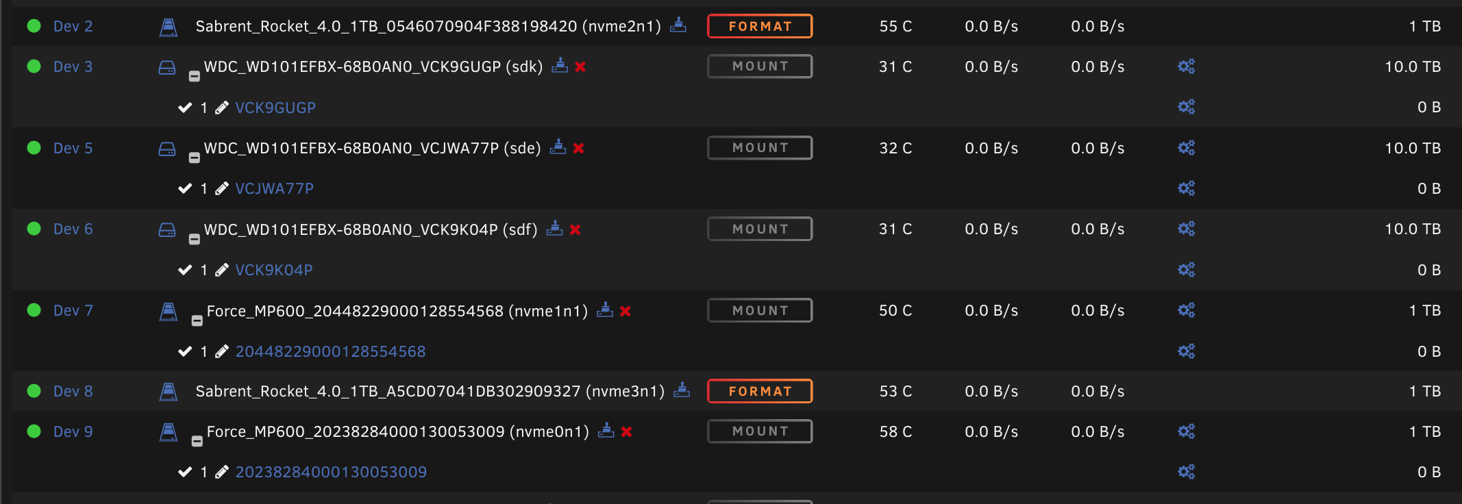

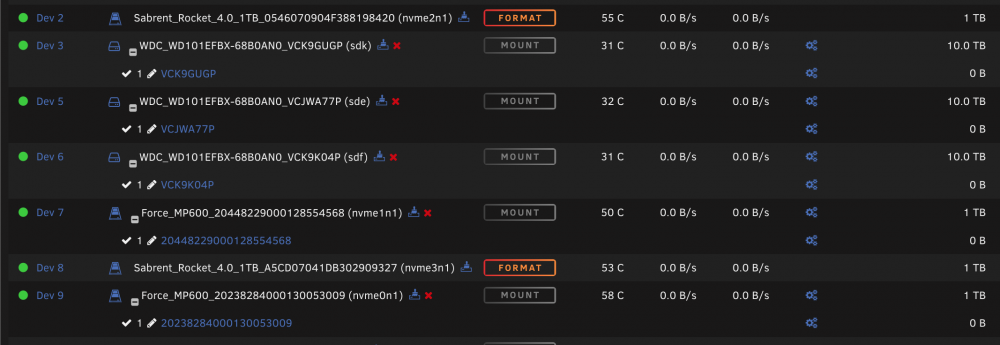

I'm having issues with two of my NVME drives, they're both Sabrent Rocket 4.0 1TB drives.
I couldn't mount the Sabrent Rocket NVMEs. After clicking on 'Mount', nothing happened.
The drives also wouldn't let me delete the original partitions. After restarting, I still couldn't 'Mount' the drives, but was able to delete the partitions.

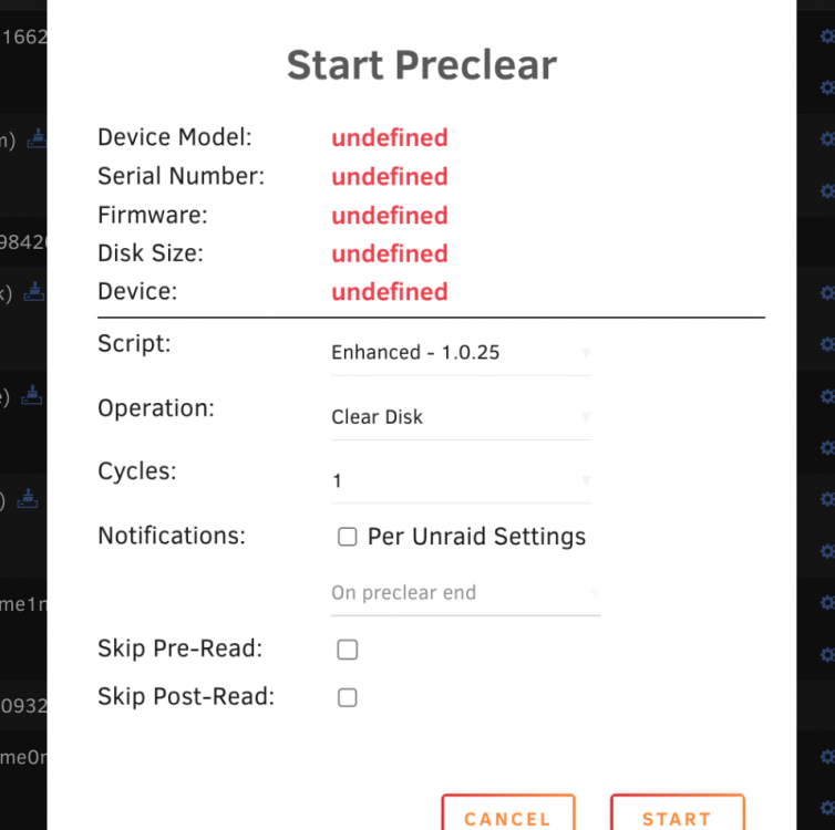

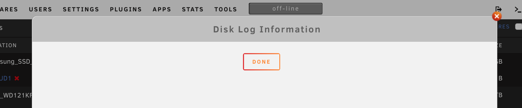

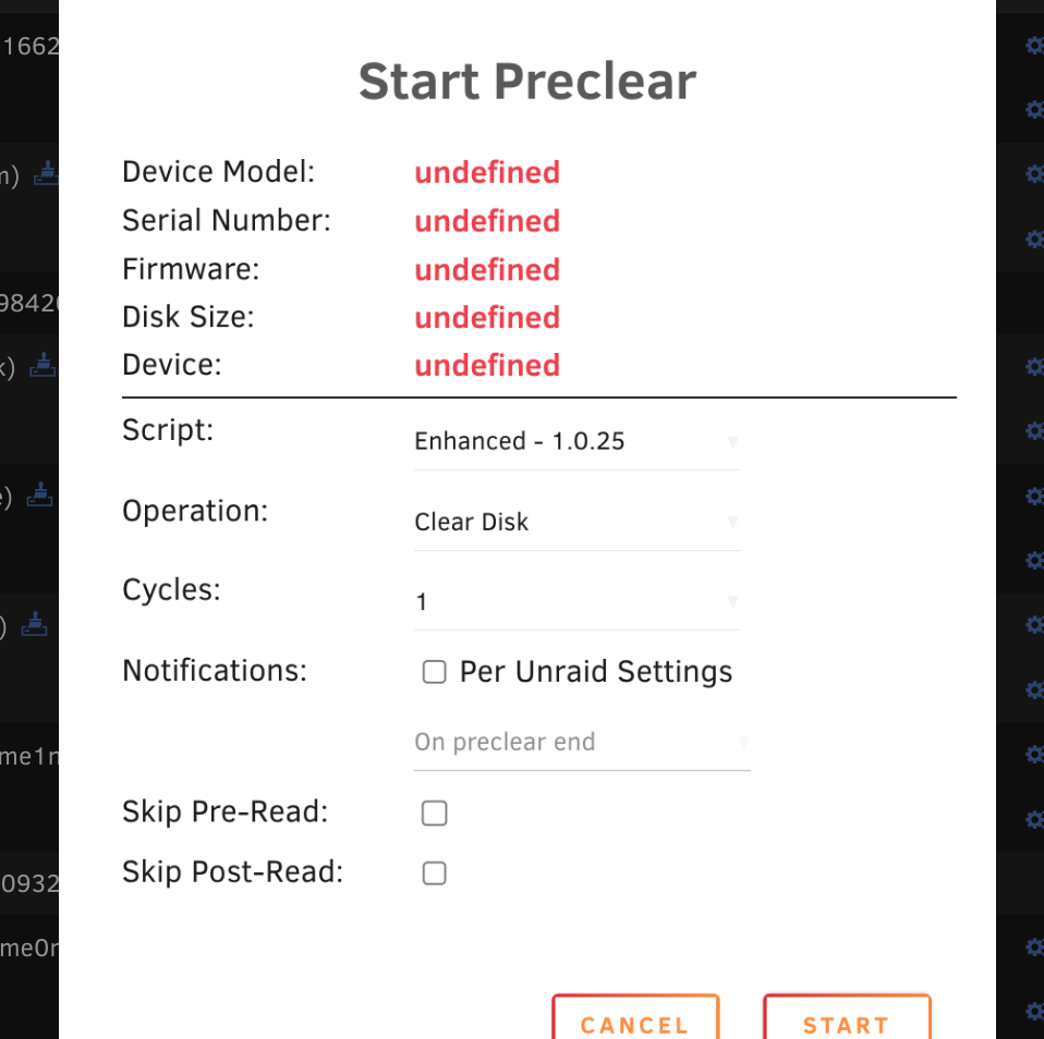

The problem I'm having now is that when I go to Preclear the NVME drives, none of the drive's info is available. There is also no Disk Log information available, but I can see everything under the devices 'Identity'.
461829332_ScreenShot2022-07-02at4_01_51PM.thumb.png.92a0945d2aa08124861ed62b72a8968e.png
Anyone have an idea of what is going on?
My hardware is in my signature.
Why are you wanting to preclear Nvme drives?
I wanted to test the drives after all the failures.
I was able to get the drives to Preclear after I started the array, but the read/write performance is horrible.
the max speed I’m getting is only 130MB/sec.

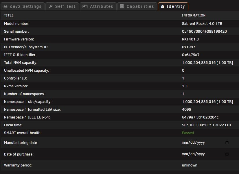

Anyone have an idea why both of my Sabrent Rocket 4.0 NVME drives Precleared at such a ridiculously slow speed of 104 MB/S taking over 3hrs to preclear a 1 TB drive?
They're PCIE 4.0 drives on a PCIE 4.0 capable motherboard. When I used unraid 6.9.2 and the previous preclear plugin from gfjardim, I was able to get over 3000 MB/S and it finished in minutes.
Attached are my diagnostics and a screenshot of the Identity page.
threadripper19-diagnostics-20220703-0923.zip
Preclearing flash devices is not recommended, you'll just be causing unnecessary wear, as for the performance try a write test to see how they are performing, if speed is the same it's likely a device problem.
