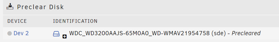

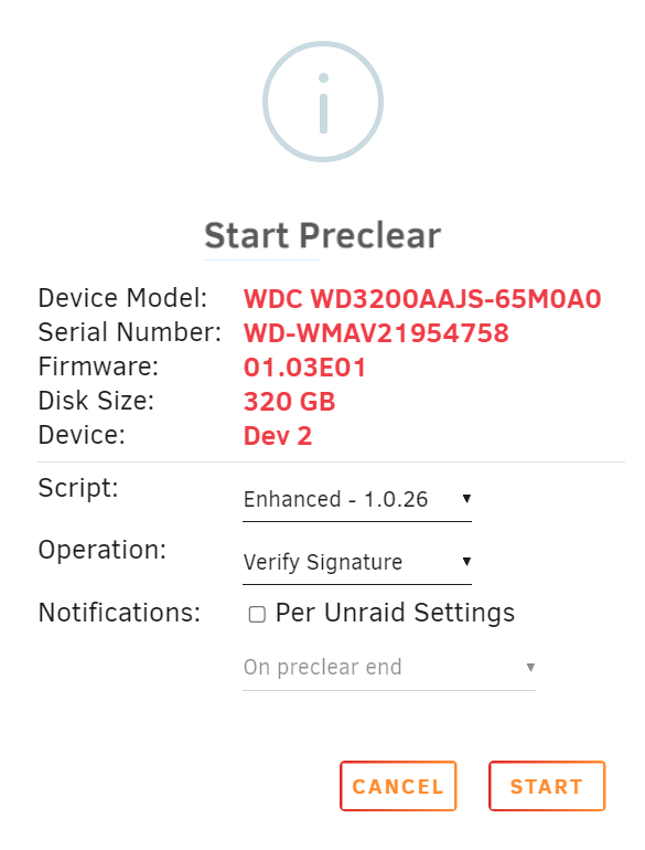

hi. is there a way i can check if a drive has been precleared or not?
thank you
thank you
Check the Preclear page:
Or run a "Verify Signature":
after server reboot, it doesnt show the precleared status
but the verify signature operation did the trick.
thank you!
