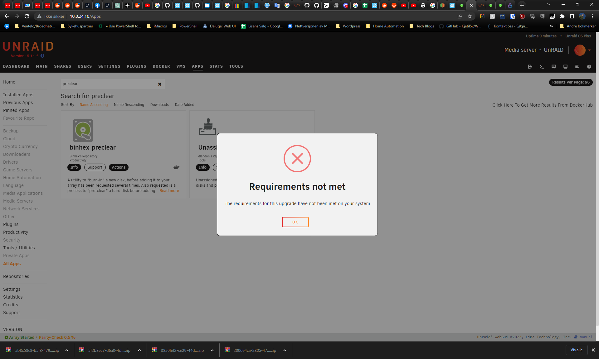

I am on 6.11.5 and I get this when trying to install "Unassigned Devices Preclear"
Have you installed the base UD plugin?
nop, that worked :)
