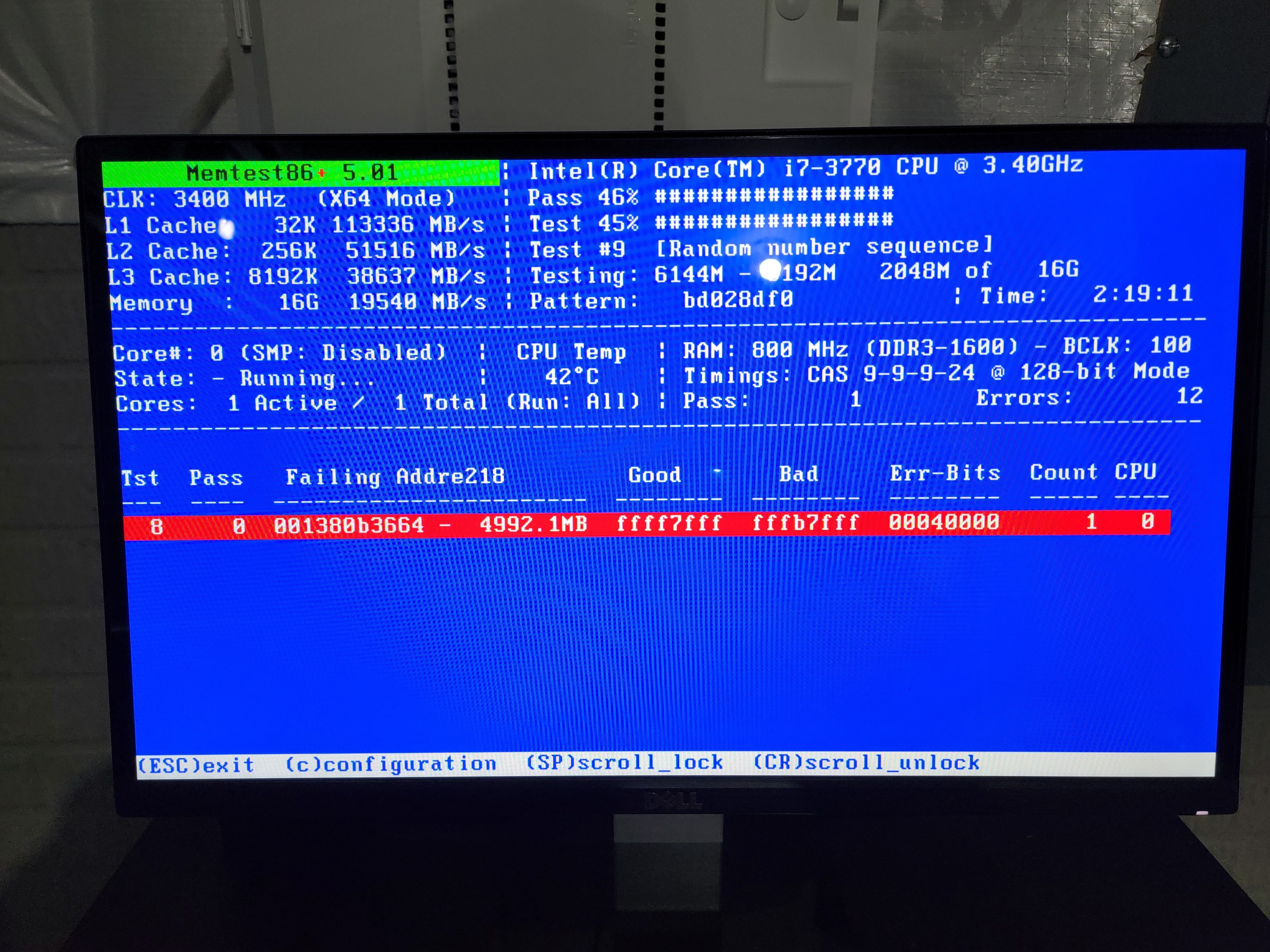

Running Memtest now.  Will run for the rest of the day and report back.  Thank you for your quick response JorgeB.
Ok so already encountered some errors.  Is there a way to determine which stick out of 4 this error is on? and is as simple as removing the bad ram and rebooting?
Tested them one a time to see if you can find the culprit.
Ok, so I found the bad stick of RAM and now am running with the remaining good 3 sticks (12GB).  However now I still have the problem of my cache pool being either read-only or full.  It is not reporting as full and I'm unsure of how to get it out of this state.  Balances fail due to being read-only and the docker service "failed to start" even after deleting the docker.img and rebooting.  Any ideas where to go from here?
