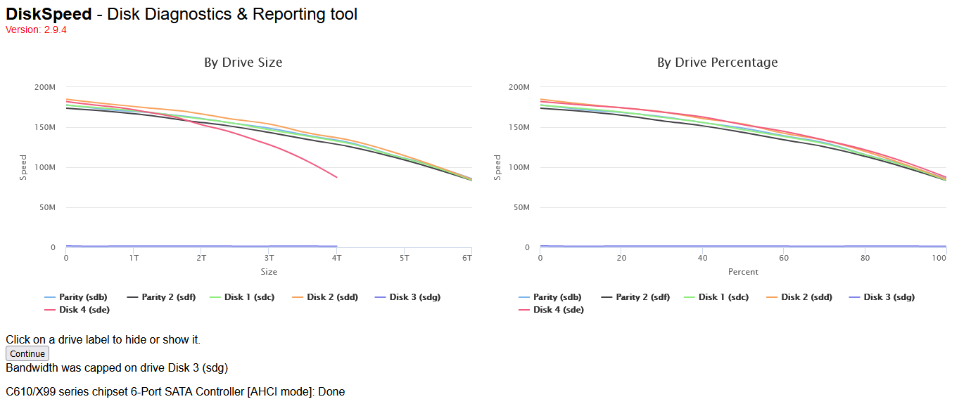

Run a read test with the diskspeed docker to see if all disks are performing normally.
Hello JorgeB, thanks for taking the time to help me, looking at this (and if i read this correctly) Disk 4 is losing performance and Disk 3 is "dead"?
what's your opinion? what should i do?
PedroFerreira_20220302_213102.tar.gz
Disk4 is OK, it's smaller than the other ones so it slows down sooner, disk3 needs to be replaced.
